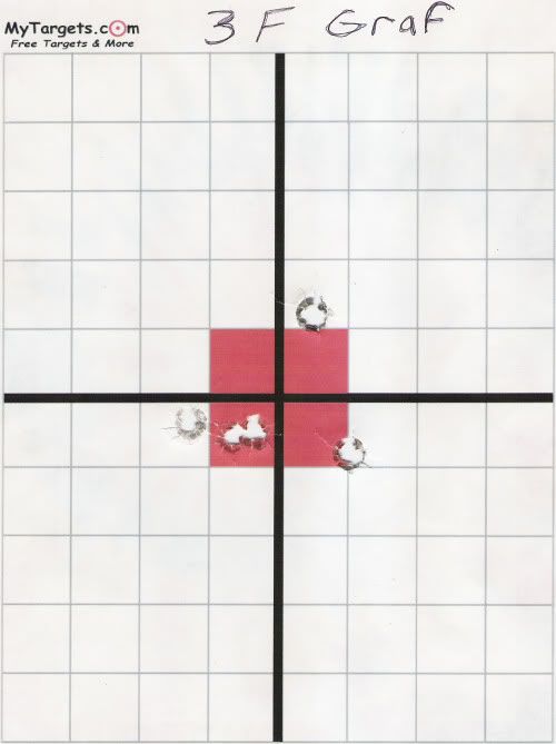

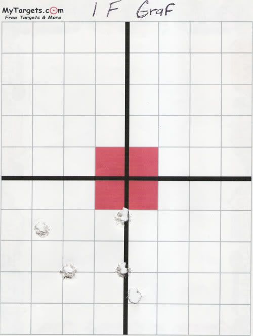

Got out today and tried out the Graf. Was shooting from the sitting position off of sticks at 100 yards. The first 5 shot group was using 1f Graf...won't be using it anymore. Well, it would take alot more playing with loads anyway. But this target was shot with 62grs., wax paper, crisco, 535gr. Postell with my lube. Wasn't impressed at all.
This second target was shot from same position, same range with sticks using 3f Graf. It was 62grs., wax paper, crisco and 535gr. Postell with my lube. At half the price of Swiss, I think I can live with it.

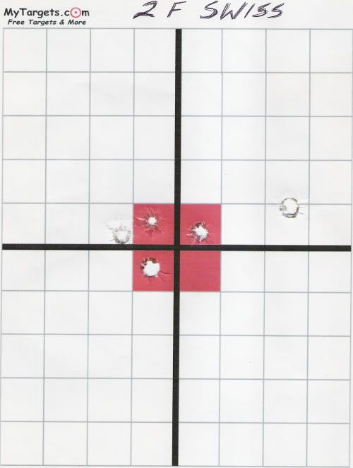

This last target was shot using my Swiss 2f powder. Load was same as others above. Would've been a good group if that flyer hadn't got me. Been awhile since I've used 2f Swiss in my cartridges, prefer 3f.

How was the fouling?  In my 38's the swiss burns a lot cleaner, with the 45-70 I was using Goex and it left a harder heavyier fouling than the swiss.
Nice groups by the way, have you tried the swiss/graf at longer ranges?
