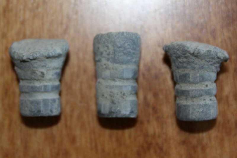

Recovered 250 grain bullets from dry sand backstop.
The 38-55 336 Marlin Cowboy is a finicky.  Much of that can be mitigated by using the long (and thin) Starline brass.  The chamber in my CB allows me to shoot bullets up to .381" using Winchester Brass.  A friend of mine's won't chamber a bullet sized above .379" in Winchester brass - luckily it shoots .379" sized bullets best.  With Starline brass he can shoot bullets up to .382", though the .379" have proven the most accurate.  Mine likes the .381" best and the Starline brass makes that easy though the thicker Winchester brass will work with bullets up to that size.  The Starline brass will chamber (in my gun) bullets up to .384".
The only real 38-55 dies out there are the RCBS Cowboy dies.  Others can be made to work but the RCBS Cowboy dies make it easy.
The 38-55 is a caliber for those with the fortitude to explore.  There are a lot of old guns and more than a few new guns.  Each of those probably has a very individual load preference.  Those with tight chambers and big bores will find it very challenging.
