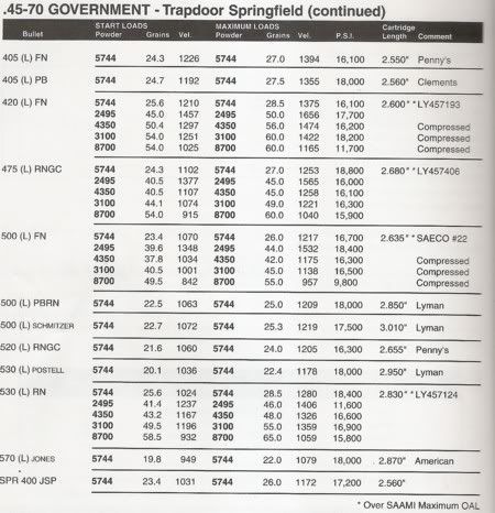

Offline quigleysharps4570
  • Posts: 107
Need Suggestions On Bullets and Powder For
« Reply #15 on: March 15, 2005, 01:31:29 PM »
Here is some trap door and modern cast and jacketed bullet data from the Accurate manual. I'm partial to 5744 for low velocities. If you'll click on the images you should be able to read them better.
« Reply #16 on: March 15, 2005, 01:50:21 PM »
That data and a lot more is available on their web site ....
http://www.accuratepowder.com/loaddata_caliber_rifle_standard_458cal.htm
