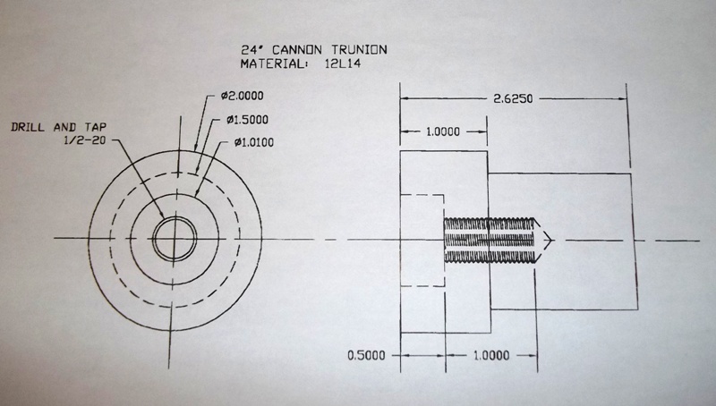

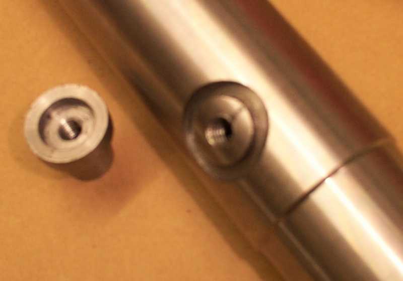

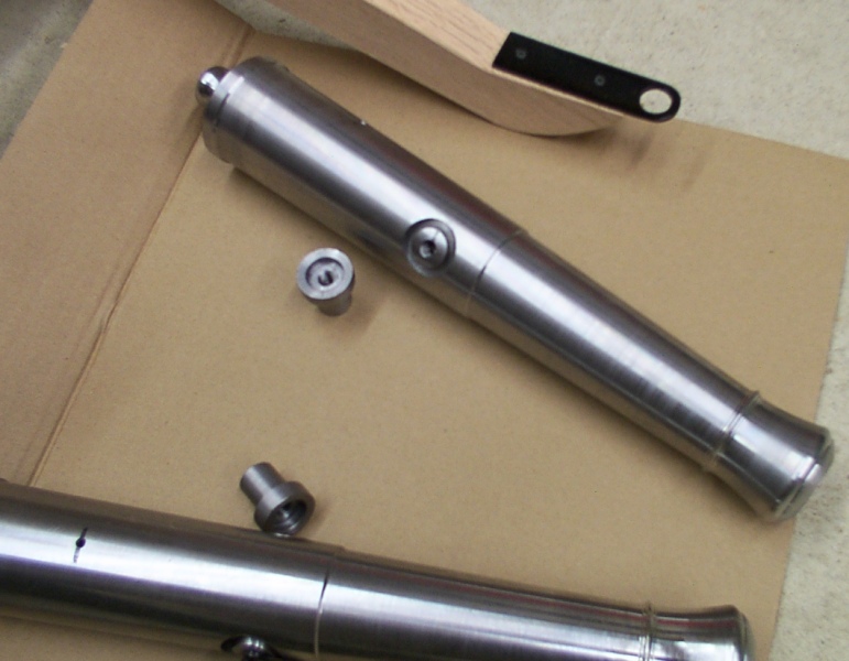

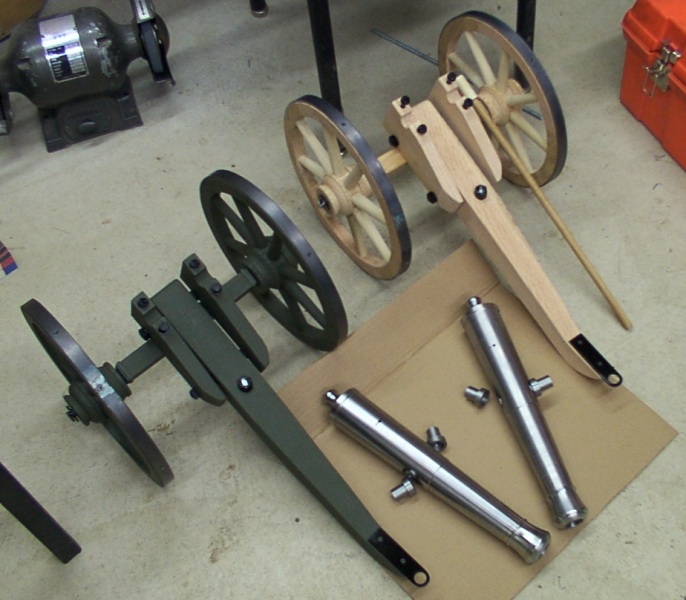

Skidmark,
I have been attaching trunnions with this method for over 20 years......... Though some have opinions of what is "best", I have tried about every method (without actually casting them in) over the years and this one has served me well. It is a well engineered and proven design. I have made several hundred cannons with trunnions installed this way without a single complaint or failure. I will post more pics over the next couple days, been really busy around here lately ! ! ;D
Dewayne

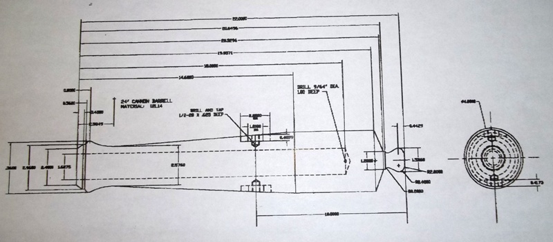

« Reply #8 on: June 08, 2013, 10:05:06 AM »
Here are some more pics, somewhere I have cad prints of the pocket and trunnion dimensions. I will try to find them, scan them in and post them here...................................
Dewayne

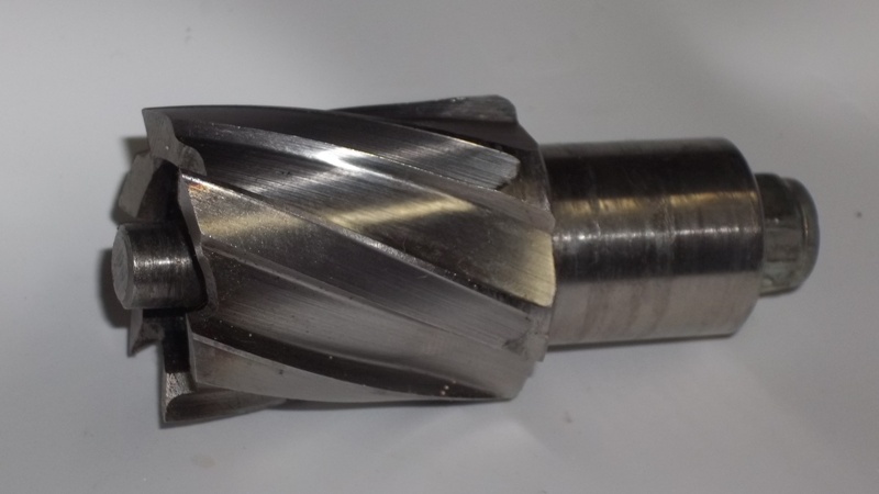

What type cutter do you use to make the round slot?
My first cutter was a trepan cutter I had sharpened to my specs. They are all done on cnc machine centers now......................................... I also took a picture of one of the barrel prints and trunnion prints I used in 2003.
Dewayne

  I guess one more option to do this process would be to use an endmill and a rotary table on the mill.
manual rotary table, manual rotary tables, manual rotary index table
Re: Science Experiment.
« Reply #12 on: June 12, 2013, 09:05:03 PM »
That would require additional tooling to hold the barrel.  You might be able to grind a special boring bar for a boring head that would start the groove, and then enlarge it with the boring head adjuster.

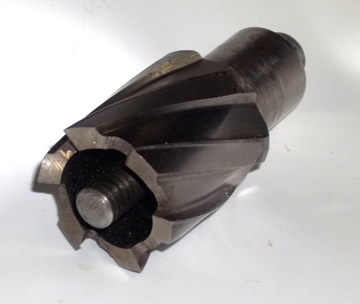

 A quick & dirty trepan tool can be made from an appropriate diameter 2 flute end mill. Grind one flute down and make the other the width of your groove and slightly longer than its depth.
 Just be sure that the X&Y slides are locked down tight when you start your cut. I come up with the knee (also tightened somewhat to take up any slop) rather than down with the quill while doing similar operations.

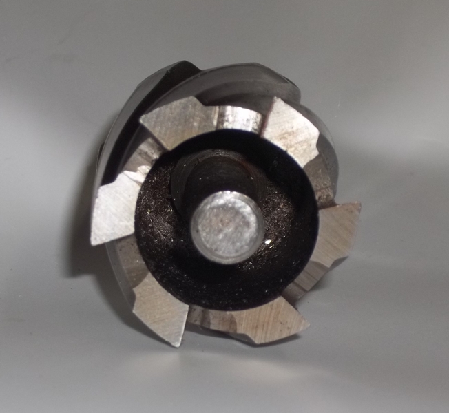

Offline de_lok
  • Posts: 309
  • ICW
    • My Photo Album
« Reply #14 on: June 14, 2013, 12:04:20 PM »
Also called Annular cutters................................. This one is similar to the one I used for 1/4 scale barrels....................
http://www.grainger.com/Grainger/SLUGGER-Annular-Cutter-4WNK8?Pid=search
