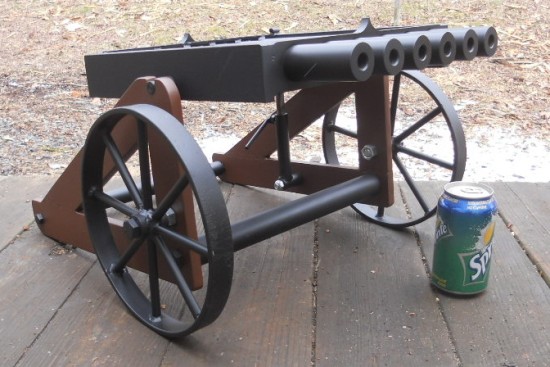

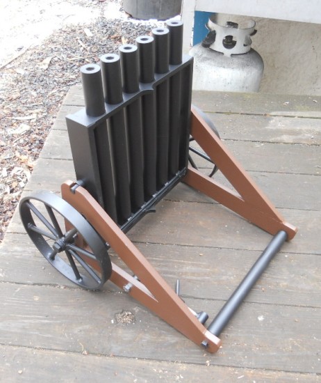

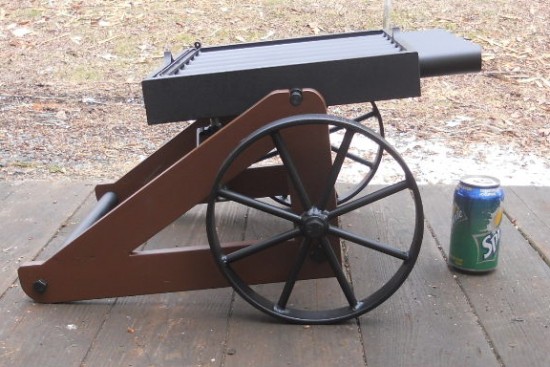

I didn't get to post photos of the last volley gun I built.  It was the breechloader that I posted last year in the late fall.  I made a field carriage for it and took it uncompleted [less paint] to a local gun show last December with the intention of not selling it.  Well, someone wave a big wad of cash at me and it was gone. I took some impromptu photos from my cell phone but they are thumbnail size and I'm having trouble uploading them top my computer.  The person who bought it said he'll send photos when the weather warms and it's painted.

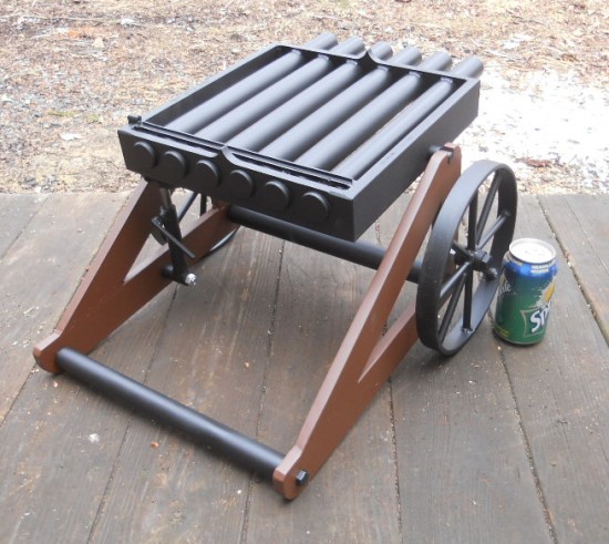

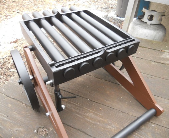

In the meanwhile, I built another.  This one is also 50 caliber but it's a muzzleloader.  The barrel assembly tilts vertical for easy loading and a safe trip down range after firing.  I am planning to make a video possibly this week when I get a warmer day.  It's also for sale.  I'm asking $950, and the shipping is included in the price. [continental US only]

     I like it a lot, Dom.  It is very unique and has a powerful look to it.  How is fire communicated from one tube to the next?  What is that lever on the left side under the back edge of the tube assy.?  Could you explain where the name comes from?  Sounds French.

The channel on the top connects to the flash holes on each barrel. Fine BP is placed in each flash hole and a line of powder in the channel. Then a piece of fuse goes through the piece of tubing on the left ending in the BP. That gives you a chance to get away and start your video camera.

     I like it a lot, Dom.  It is very unique and has a powerful look to it.    ...What is that lever on the left side under the back edge of the tube assy.?...[/i]  Tracy
Tracy,  thanks for the compliment.  The handle is part of the locking bolt for the slide elevation tube.
