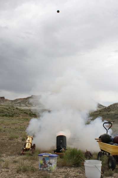

This is mine, 6in.x6in. powder chamber inside and 2 in.trunnion welded to it and the tube,The base is white pine and  piece of plywood on bottom, 18 wideby 30 in. long, Works great, my other one was made of oak and wanted to see what pine would do and has held up fine, hope this helps, Joe

 this is mine 2.25"BY 1.5" CHAMBER WITH 1.5 CALIBER BARREL LENGTH
OAK SLED 255 LBS 3"TRUNION 6" THICK ROUND BOTTOM TO FIT SCH 120  PIPE OVER 1" WALLS  3 OZ FULL CHARGE BB FLY'S 500 YD"S.
