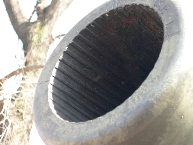

    Anyone have pix of a Handi with microgroove in 45-70 and/or Ballard rifling?
I seem to recall when I called H&R 1871 they said all the currrent one's were Ballard... finally got to the LGS to fill out the paperwork on the one I just ordered... the rifling seemed very shallow to my eyes. Maybe it's just the size of the bore makes it look that way though.
Anyway, microgroove in the old Marlin .22's was very easy to spot. With this gun I'm not sure if it's Micro... or just very shallow Ballard?

I'd say it looks like that pic in the earlier post. So chalk it up to another mis-informed rep. Was hoping I was wrong and that ballard just doesn't look as deep in a bigger bore. :(
My main beef with it is that it just looks very weakly rifled, as in already shot out... fragile even.
Well, for better or worse, I finally got around to getting one... will have to see how she does. :)

To be honest, I'm still not sure if it's MG or not. Will have to wait until I get it home... waiting period in this state. MG that I'd seen in the past always looked a little "pointy" whereas this just looked like very shallow Ballard, but not sure. Could be an optical illusion of the larger bore perhaps vrs. the 30 cal. rifles I've got on hand.
It did not look like this, for example:
https://www.gboreloaded.com/mhp/images/Steelbanger/microgroove.jpg
Nor this..
http://s349.beta.photobucket.com/user/StockersPics/media/L07D027-4.jpg.html
It just didn't have so many lands that I could say, "Yep, definitely MG..."
I'll have to wait and have another look.
Nor this..
Read the article by Fryxell I posted...
http://www.lasc.us/FryxellMarlin-MicroGroove.htm

I'm not worried about it being possible to craft loads for it. As you point out folks make it work. Though I wonder at how much additional effort?
What really crossed my mind is... is the lands look so shallow that I'm thinking it would take much leading, nor much corrosion to have a less than good situation.
Makes me wonder if paper patching would tend to round off the lands rather quickly as well.
As ridiculous as this is going to sound, I sent may a lead .22 down range with a cheap little Jennings J-22 that was MG. It was crazy accurate, and a basic piece of cheap metal junk. So no worries about it being able to work. Just wondering what the downsides are. What I'm seeing makes me think... "That looks a little fragile"... relatively speaking of course. It is steel after all.
That said, how many bazillions of Marlins were microgrooved... plenty. So it works. So did polygonal rifling and even elliptical boring. So's as long as it imparts the spin and the bullet stays balanced, it should work.  Will just have to be sure I stay the usual .001 - .002 above groove size.
I dunno, just expected to see more substantial rifling in there.
About the Fryxell article... this statement is what worries me, because the whole point of buying this gun was to go with PB Cast, soft lead bullets. I.e. easiest to make bullets:
" Other examples can be found in the .30-30, .32 Special, .444 Marlin, etc., but you get the point. Microgroove rifles can shoot cast bullets just fine -- just keep them oversized, GC-ed and hard enough."
About I don't want to fuss with gas checks, alloys, etc. I wanted a forgiving rifle that would digest a wide range of loads without a lot of tuning. Otherwise there's no advantage to me... if it needs a lot of tuning, might as well tune a .30 GC bullet for a milsurp and have flatter trajectory and a repeater.
If it needs GC, Paper Patch, or Jacketed or some especially hard alloy... it's completely counter to the whole tree I was barking up. LOL!

Good article. But it points out that MG barrels have requirements that seem to contradict my whole point in going for a 45-70. Which was simplest bullet cast, no need for high velocities to get the job done, so no jacketed, paper patched or gas checked bullets, and ideally no sizing or bumping up routines.
Consider how this statement contradicts that goal:
And this one:
Because of the specifications adopted by Marlin, Microgroove barrels tend to have oversized groove diameters, and as a result, Microgroove barrels early on earned a reputation for not shooting cast bullets well. In fact, when loaded with bullets that are the appropriate size for the barrel (and cast to a suitable hardness and wearing a GC), these guns are capable of fine accuracy with cast bullets. Some of my favorite cast bullet rifles wear Microgroove barrels.
That's all the fussing around that I was hoping to avoid that .30 cal rifles require to get to the velocities needed to get the performance associated with them. Well, and or buying some Corbin Equipment and making your own jacketed.
The whole idea was to be just one step above black powder really.
Kinda P.O.'s at Marlin and or the rep on their phone line that said, "All the 45-70s are Ballard these days." Assuming this barrel really is MG. Have to wait out the state waiting period to get it home and have another look.
I'm just gonna hope that it shoots. At the very least it's got to be better than a smooth bore slug gun, LOL!
