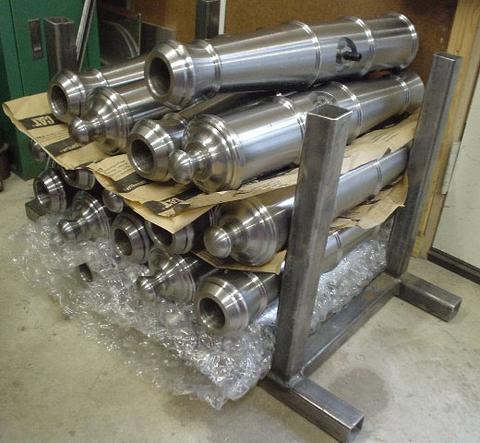

Yea..................................meanwhile this was in my shop while they were "sold out" >:(
When I am ready to start selling again I will do it all directly and not thru other outlets.
Took me 5 years to sell them down, I have only one left.............and it's MINE ;D ;D ;D ;D  I'm thinking about building a 18th century style split trail carriage for it when Im done with my current project.......
