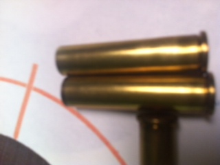

Fascinating.  Could you post some closeup pictures of the shot brass?

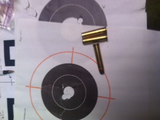

<img src="https://www.gboreloaded.com/mhp/images/jkkj/cases.jpg" alt="image hosting by https://www.gboreloaded.com/mhp/" />
It is not as clear as I hoped for.  The case measures out .001 smaller at the end than it does toward the back,  and the bullet does drop in with no force.  There are a couple of scrapes on the end of the case, like the roughness in the new area has scraped it as it has came out.  Again not difficulty exstracting either.  You can see them but not feel them with your fingernail.  I will probably buy a finish chamber reamer to clean it up.
I'm not a professional internet sqabbler so I probably will not respond to this thread again.  I appreciate the honest oppinions and I will continue to watch the brass for signs of to much pressure.
