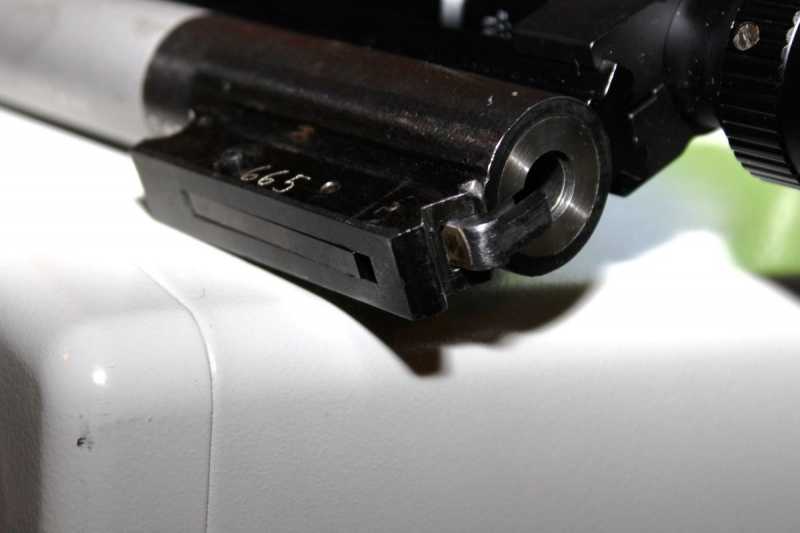

Re: Help: Extraction Problems
« Reply #5 on: January 19, 2013, 08:16:51 AM »
Dinny's pic is an ejector, my pic is an extractor.
« Reply #6 on: January 19, 2013, 08:18:05 AM »
I now believe it was an extractor??
Thanks, Dinny
That's the barrrel. So that's an extractor? Because upon reading the FAQ, I would have thought I was wrong and it was an ejector.
« Reply #7 on: January 19, 2013, 08:18:29 AM »
Dinny's pic is an ejector.
I just compared my other barrel. I concur. :)
