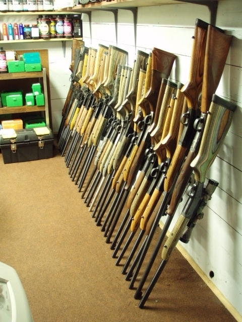

Re: Help. H&R .243 not grouping.
« Reply #4 on: December 16, 2012, 10:29:35 AM »
Welcome Doyle!  ;) What they all said, read the Handi Basics 101 sticky, it's all there just for the readin.  8)

« Reply #5 on: December 16, 2012, 12:59:16 PM »
Nice collection quickdtoo!

« Reply #6 on: December 17, 2012, 07:28:05 AM »
It wouldn't take me 5 minutes to nock all of Tims rifles over if I were there.   :o    ;D

« Reply #8 on: December 17, 2012, 08:11:50 PM »
i see quik you don't like plastic much either.nice collection ;)
