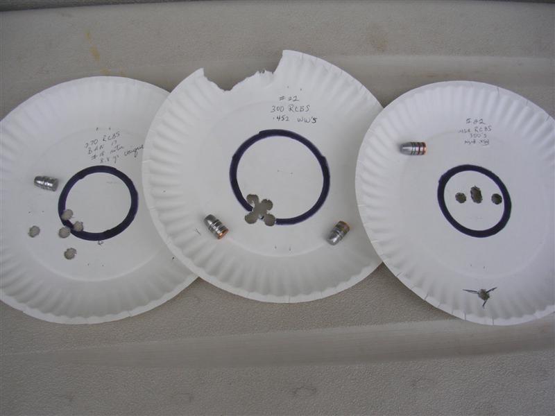

I must have been lucky!!  I have had one since they where first offered... I fit and installed a free spin pawl and a over sized cylinder pin. Then a set of Wolff springs and Black Pearle grips...
I load a stiff loading of WW296 and a 300 Speer SP gets me under 4"at 100 and cloverleafs at 25...
