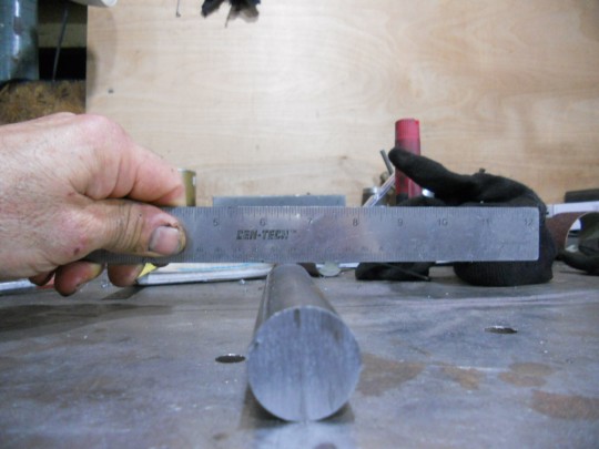

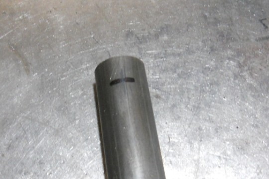

I use a steel straight edge to find the vent location centerline.  I use two, same size, blocks of steel under the trunnions to level the barrel from the front view. Then put a 1/16" or small diameter rod down the bore and bottom it out to find the back of the bore.  Mark the rod at the barrel front edge and use the rod on top of the barrel as a length standard to locate the back of the bore.  Place a mark on the top of the barrel, 1/4" in front of the back of the bore. If the back of the bore is a drill point or dished, you want to make sure the mark is in front of this so the drill bit will come through at the straight cylindrical part of the bore ahead of this transition, otherwise you could snap the bit when it comes through.  I use a black marker and mark the top of the barrel for the front to rear measurement.  Then I use a steel straight edge and eye sight it level with the trunnions  and scrape it back and forth to scratch a mark through the black marker line. This scratch mark will be top dead center and where it intersects the black mark is the vent location.   Photos below.
