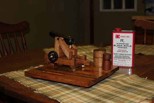

I used a technique that is halfway between painting and black phosphate coating. This was a miniature firecracker launcher, so I was able to acid rust the parts by placing in a quart jar with a small amount of diluted hydrochloric acid in the bottom. I suppose the initial stage of a plum brown kit might work as well. The lightly rusted surface was then painted with the liquid rust reforming primer that uses phosphoric acid to convert the rust to black phosphate and seals with an acrylic. The jury is still out on long term durability, but it appears to be fairly tough.

Any chance on a series of close ups on the firecracker cannon? Please!   8)

 I too would like to see the firecracker cannon closer.  It looks good in the photo and I like the idea of the technique.  Rludwig, what was the rust converter you used.  I have use one called Rust Mortimer on cars before but never heard of using it as a finish.  By the way does anyone know if there is technically any difference between industrial black oxide and bluing.
