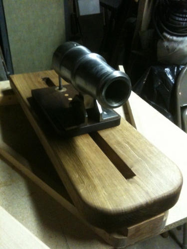

My rendition of the carronade, with a bit of a deck to shoot off of.
Re: The Carronade
« Reply #7 on: September 01, 2012, 06:50:12 AM »
Thaks for the vid, Ivar. You did a fine job on that build.
