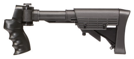

These are on eBay from $75 up.
ATI MOSSBERG 500 6 POSITION SIDE FOLDING TACTICAL STOCK
They still have to be fitted to the receiver,
......but there is no paintball in their name.
I bought one, I'll try it.
......maybe it will suit the 300BLK well enough that ATI will make them for the Handi!

I got this in today,
It is very solid,
and it looks like it may just bolt on.
It is very solid,
New lowest price is $55.
They don't just bolt on, it took some fitting.
...but! it is solid. If I wanted a folder on a 45-70 I would use one of these.
Now all I need is the 300BLK to put it on.

fitting was just grind the face of the stock to match the back of the receiver?
The stock is a heavy black plastic.
I used a blade on a dremel
...and mostly cut a slot for the edge of the back of the receiver to fit into.
It's an easy material to work, but this is the third one like it I have done.
               (There is a learning curve)
  Does the stock bolt fit fine,  Longer?  Shorter?
I used an older screw-type stock bolt that was a perfect fit.
A hex-head would have to be ground much smaller and have a slot or 2 cut for a screw-driver.
   how is the height for using your scope?
It comes with an adjustable cheek-piece that I haven't installed.
The adjustable cheek-piece may be perfect for a Handi since different barrels might call for different heights.
The cheek piece seemed OK for this set-up.

Re: Another Folding stock for a Handi
« Reply #25 on: July 26, 2012, 09:09:00 AM »
Thanks for the nice words.
That fore end is the one that comes with the ATI collapsible stock.
