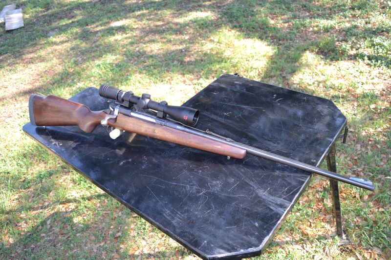

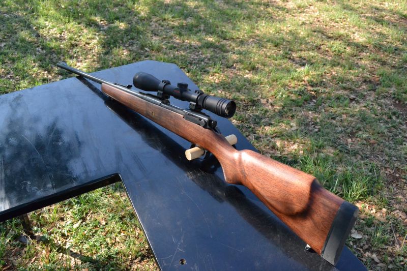

Some have followed this project a bit, but here's the recap.  I had a 1917 Enfield in 30-06 that was my father's.  The barrel was pitted bad and it wouldn't shoot worth anything.  I decided to do a rebore on it and sent it to Dan Pedersen at Classic Barrel and Gun Works in Prescott, AZ.  He rebored and rechambered it to 338-06.  I refinished the stock and installed a limbsaver recoil pad on it.  It now has a Dayton trigger on it and wears Warne rings and a Redfield 4-12x40.  Here's how it looks all finished:
It seems to like 51 grains of Varget pushing a 225gr Hornady SST but will sling one out about every three shots.  It may be a bedding issue or the brass since I'm sizing up from 30-06 brass and the necks are short from the resize.  The case stretch is minimal and there are no signs of pressure so I hope it'll settle in a bit with these loads.  I will most likely bed it, but I'm having too much fun shooting it to mess with it right now.

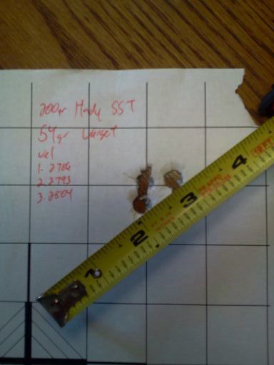

After moving, I finally got some more loads developed and got back out to the range.  This time I went with some 200gr Hornady SST's to see if Enfield liked them.  Started at 53grs of Varget working up to a max of 56.5 in .5gr increments.  Got to 54grs and shot this:
At .662" I figure that's pretty good, considering I did a lot of the work on the rifle and I was the one squeezing the trigger.  These three shots chrono'd at an average of 2794fps.  The 55gr load actually grouped the second best at 1" and was 50fps faster, but I think I'll stick with this load.

Holy Mack'll there Andy!!!   :o
That accuracy with a 200 gr. bullet and 2800 fps (+/-)!  :o   I don't think I would worry about any further load development!   ;D
