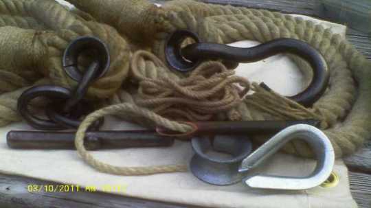

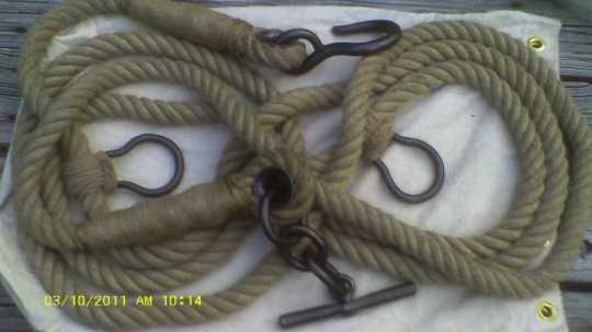

  Hello all. I ask about building this prolong last month ,got no reply so gave it my best . I used AOP's prints  and learned a few thing on why certain measurements don't work out .IE the swivle-rivet length being only 2" as the toggle,s forgre eye-hole reduces the 3/4" .
Most interesting was that the hooks shape and size allows it to go over the pintle,as the 1860's ring, but not come off thought the throat .
 I worked along time to get all materials together . The rope is pure 4 Stand Hemp 3.5" untreated ,not the Philippine manila they try passing as hemp on the internet . Also the lashing and marline are hemp . The work shop sure smells interesting also and the musk smell of Jojoba oil I finish rubbed into it .

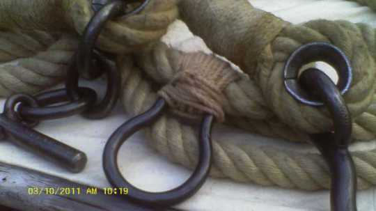

  Also posted is pic showing closer view of metal work hook, toggle and d-rings? .Also is my homemade fid to splice , some left-over marline and lashing 3 stand cord . The rope has a soft finish to it and swells considerabily when wet . The marline was left unfinished to aid drying as rotting has been noted in tarred splices . Glue was added at knots and ends to keep locked . Still tring to figure what the rings are for and comments on the lashing on of them.

very nice work

Very nice work. Just a couple of questions. Where did you buy the hemp from and what are the two eye lets that you have lashed in between the hooks.

 The hook and toggle rings both go though 1.1" thimbles . Most thimbles are pear shape like one in pic next to the round 1 3/8 one ;like ones I cut down and reformed to 1.1" . The hemp is now legal to import my stuff came from the Netherlands back in 2006 . I been working on this project since way before then . I' ll get the companies info that retails it here in U.S.

I think the rings are for attaching the cannoneers bricole harness for moving guns without horses. I don't know how they were attached but they would have been attached very securely.
