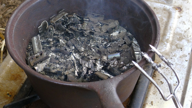

Gave casting a quick try this weekend. When I get a chance I'll do it the right way. I have my first bullet and that's it. One side looks decent, the other side has flaws. I don't think I had the lead hot enough. The thrift store ladle did not work at all, so I'm on the lookout for something better.

looks to cold to me too. Try dipping your mold right in the lead to heat it up.  About 10 to 15 seconds will do it. Dont worry about shinny bullets. Lee aluminum molds work best when there so hot that there right on the verge of smearing lead on the spruce plate. With lee molds your going to want your bullets to look frosty when they come out using ww.

I think a nice heavy cast iron ladle heated up would help to keep the lead at temp also. A little pour spout would make it easier to hit the hole.
I have one that looks like this. It is a smaller and does not have the trough just a spout.
http://www.rotometals.com/product-p/Casting_Ladle_bottom8.htm?gclid=COawppX3zK8CFYe5KgodtyQ7Zg

most plumbing supplies will have a nice laddle to help pour lead. Also antique stores often have them. Enjoy you SA's they are fun ..............

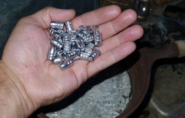

I picked up a little ladle for a couple bucks at the store and gave the casting another try this evening. I threw a little glob of beeswax on the melt for flux. Everything went like a dream and I got 30 bullets with my lbt mold. I'm happy.

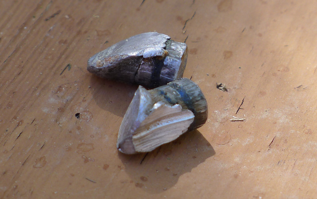

This is what the bullets look like after hitting the backstop while target shooting.
