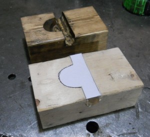

When I sell a mortar barrel, I have a template sheet that is enclosed with the instructions for rough cutting the barrel fit.  I use a die grinder to notch for the barrel.  It's easy to cut too much with it though. I like your chisel method better.

Re: Inletting a cannon base, basics
« Reply #15 on: March 30, 2012, 02:27:28 PM »
Template helps gets started.  The final shape of the inlet will be elliptical. I start by just tracing around the base with pencil.
