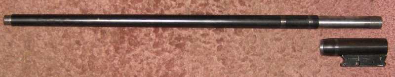

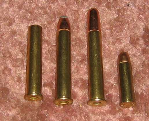

I've got a 375 Winchester just about done, used a takeoff Weatherby Magunum barrel.  Should be quite a thumper I would say.  The cartridge on the right is a 38 special for comparison.  Larry

What it the longer bore riding bullet?  It looks very interesting.

Fancy lookin' 38-55 you've got there, Lar.

A fancy 38-55 that can utilize commonly available jacketed .375" bullets instead of playin with uncommon oversize cast bullets!  ;D

OK, close enough to a 38-55, even though a bit shy of being a 'real .38 cal.  ;)
