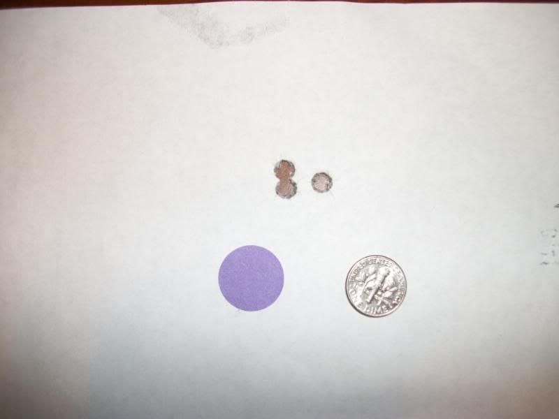

Sorry it's taken so long to get back with this info.
MGM was good to work with. They did and accuracy test and checked the chamber. Everything looked good.
They supplied me with 2 targets and load data for each that was right around an inch.
They only charged me shipping because they were longer than expected.
Here is the targets they sent me
Well I was still unhappy. $400 for a barrel that doesn't even shoot as good as my factory barrels is very dissapointing.
I decided to take there load data and start working on some more loads to see what I could come up with.
After several frustrating attempts I was ready to cut my losses and sale.
I sat down last night and loaded up one more batch of different loads to give it one more try.
Today was my lucky day.
140 gr Partition
62 grs Retumbo
CCI 250
COAL 3.260
Produced the reuslts I have been looking for
This was the best one of the buch
This has been my first custom barrel and the most frusrtating barrel I have ever had to find a load for.
I am very happy with it now but I think in the future I will just stick to factory barrels.
