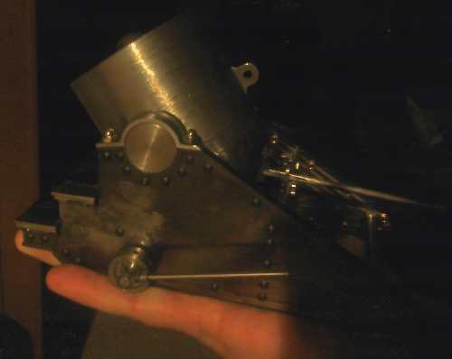

Hi all, I've been working on a 1/16th-scale M1861 (150th Anniversary?!) 13" Seacoast mortar-- mostly off William Green's plans for a 1/8th scale firing "Dictator" model with modifications for the size shrink and to get a some more bolts on there (cosmetic only, most of them).  If anybody's interested, I can probably put together some construction photos into a build log of sorts.  Here's the blurry 'artsy' photo to hide the rough edges ;)
[Edit: Here's the build thread: http://www.gboreloaded.com/forums/index.php/topic,237417.msg1099345534.html ]
Anyway, it's done enough to fire so now I'm poking around for loads to try in this thing and not coming up with a lot specifically for mortars-- the FAQ thread chart suggest about 100 grains is reasonable for a 3/4" bore cannon.  The Green plans suggest 80 grains for the 2x larger version.  Neither suggest a powder size; I have a little 4F on hand and can find typical BP rifle supplies locally (though not likely cannon-grade).   The tube is probably only 1018 steel, but 2.8" dia with a 3/4" bore (slightly over for windage actually), so lots of steel all the way around.
I have some 3/4" ball bearings which might not be ideal shot, but are on-hand-- is 100 grains really ok for a steel ball?  About how far is it likely to fly? 20 yards? 200?  l'll likely mostly shoot blank loads, so suggestions for loads/wads/etc there would be appreciated as well.

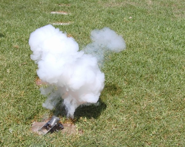

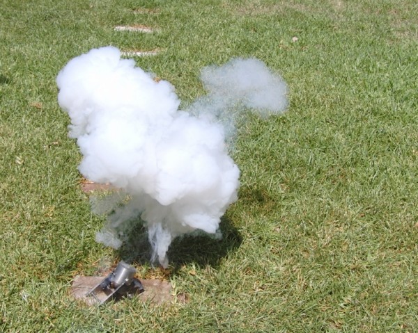

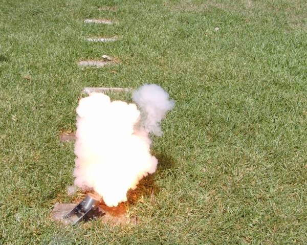

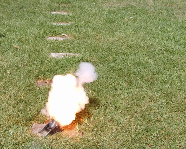

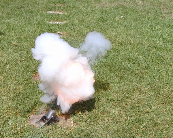

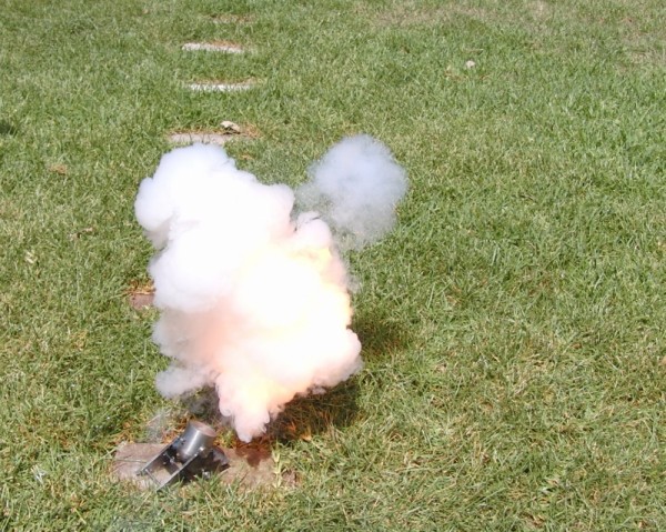

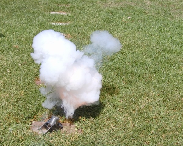

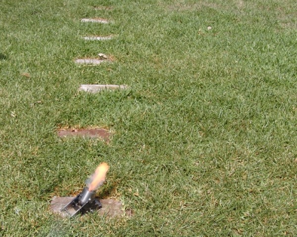

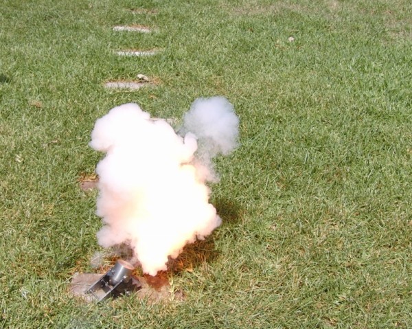

Finally got around to shooting some smoke-n-flame pics from this guy.  These are all one firing photographed at 60 frames per second.
One .45 LC case full of 4F loaded loose.  Unless they see the smoke cloud the neighbors don't even notice.
Ignition!
Just  bit of orange fire left
fire all gone
