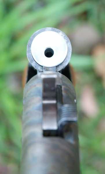

Just a follow up on the thread about adapters.  You may want to orientate your adapter in the chamber each time.  Centerfires will need to be marked with a sharpie or something.  In rimfires I just used the offset chamber shown below in the 6 oclock position.
In the 9 inch paper plate you can see the impact almost mimicking the orientation.  12 oclock was high and left, 3 oclock was right, 6 was low and 9 was even further left.  Range was only about 20 ft too.  The shell size adapter shown on the plate.

How about shooting a group of 10 or so all with the orientaion the same, say 12:00 o'clock or 6:00 o'clock since they seem to be the closest to the point of aim, and posting the picture for us with the brand of insert (it looks like a Dinaarms, is it?) and the distance...Thanks in advance....<><.... :)

It's a Dinaarms 12 Ga to .22 rf and I did shoot a group.  Moved the second plate out to about 30 feet or so and shot a five shot group with the adapter in the 12 oclock position.  I was ashamed to show it though.  Two totally missed the plate.  My adapter has the ring for the O-ring but they did not include it.  I it was rattling around in that chamber after those first few shots.  Got me excited at first.  Before I set the plates out I took a quick shot from the bluff down to a can in the water in a drainage canal about 35 feet below and it shot water up right at or in the can.  Sights is just the bead floating on the rear frame of my Partner 12 Ga.
BTW the notch in the plate is just to show "this side up".
