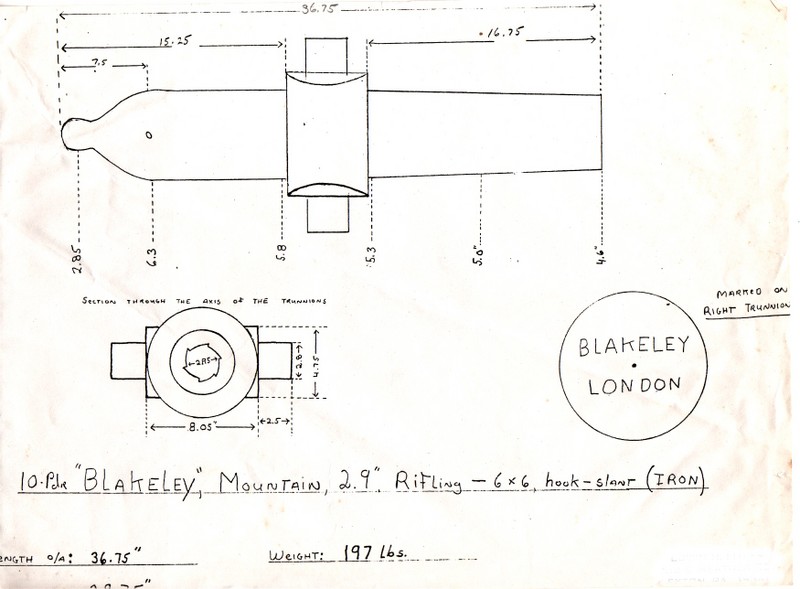

 I have come across this gun and was wondering does anyone have prints for this gun or know where one is located at so I can get dimensions  off of it? would it be aproved to shoot off of a praire carriage?
2.9-inch Blakely rifle, Type 10. Total length, 36.45 inches; maker, unknown; rifling, 6-groove sawtooth, right-hand twist; weight, 197 pounds (per scale); known survivors, 3, one of which is marked "BLAKELEY(sic)/LONDON." Little is known of these except for the presence of the survivors.

rampa room artillery,
 I know that Cpt Ed owned one sometime back. He no longer owns it as of this time. However, he did make some hand drawings detailing the tube. He posted them awhile back. I'll see if I can locate that post.
***Here is the original post.
http://www.gboreloaded.com/forums/index.php/topic,102590.msg1098296108.html#msg1098296108

Drawings like this

The gun in Cpt. Ed's fine drawing was acquired (when, directly, indirectly we don't know) by the late, well-known Atlanta collector and friend George W. Wray, Jr.  It is now in storage of the Atlanta History Center, and I discussed it recently with curator and fellow Company of Military Historians member Gordon Jones.  I'm glad this drawing was posted here because the AHC doesn't have it, nor the earlier history of the piece, but they will as soon as I write an email with the link to this topic.  This gun is probably unique in the world for a type 10 having the misspelled "Blakeley" mark, so that's why I'm 99.99% sure it is the same item.  Glad you posted that drawing-now we can work on completing the provenance of that interesting piece!
