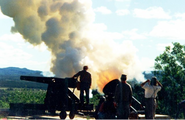

I was part of this crew that worked a 13 inch seacoast mortar, and no the image was not taken during the Civil War.
This mortar weighs 17,000 lbs and with the bed over 10 tons.  We were firing a 200 lb shell using 5 lbs of powder to a range of 1 mile.  The recoil caused the mortar to move about 8-10 inches on the platform.  This was a relatively light charge.  So I would agree that the thickness of the barrel was due in part because of the pressures and in part because of the recoil.
That second picture is awesome got anymore that capture the whole plume?
Re: Civil War seacoast mortars, why such thick tubes?
« Reply #3 on: February 11, 2012, 03:37:32 PM »
The second one looks like Range 10 at Fort McCoy, WI. by the Paulson brothers.  I imaging there are quite a few pictures around from those shoots.

Both were taken at McCoy.
