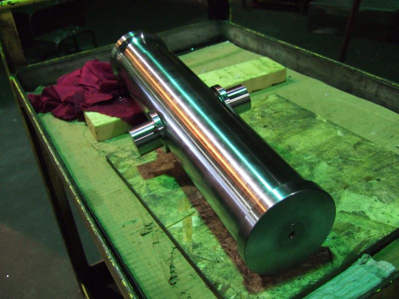

This is the design I used to build my howitzer. I have been shooting a 4lb  - 3" solid steel ball with 1-1/2 oz FG powder. The sub-chamber only holds about 2-1/2 oz for blank charges. I have also with some success shot 3" dia x 4" long aluminum round bars and some 3" dia x 6" long hardwood plugs.
I ended up making two plugs, tried .010" press but it only shrank about .007" with liquid nitrogen. I made a new plug with .005" press and it shouldered out without any problems. I work at a machine shop and had a certified welder do the pre-heat, weld and post heat.
I also had the trunions welded on before boring the barrel.
If you are interested I can send you my CAD file and you can scale it to the size your wanting.
Steve Seib
