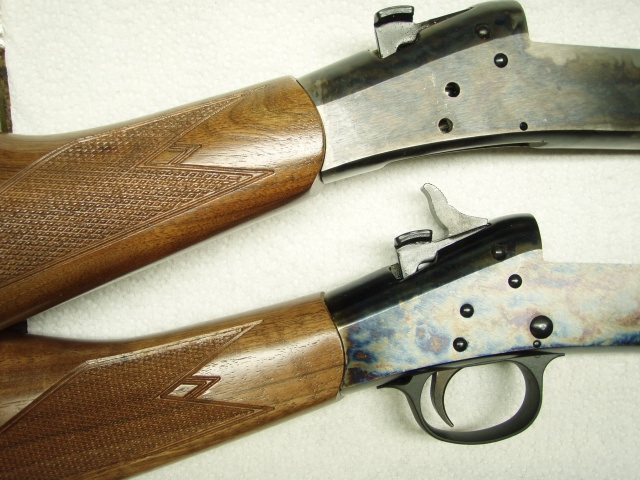

That is a question i have. is there a reason that the stocks are left so much bigger than the reciever where they meet. I haven't messed any with a customizing one yet but always thought that it would look a lot nicer if the wood reciever joint was flush.

This is just my theory on that and I'm sure someone probably has the more correct answer, but I believe it's because the stocks are made as a one size fits all and the tolerances and size of the bolt hole are exaggerated.    The stock is a pinch fit meaning it's not going to be in the exact close tolerance spot from rifle to rifle and it's just the amount of pressure applied to the stock bolt that actually holds the stock in place.
The stocks are assembly line made, and then when it comes time to assemble the rifle, it's less time consuming to not have to line up each and every stock during assembly and probably why these rifles are less expensive than others.
Just my thoughts on why, but I understand where the original makers of the Handi Rifle were coming from.

Not all H&R wood stocks are so proudly fitted at the frame, they've varied over the years a lot, here's an example of two BC stocks, the top one is a 2005 on my 45-120, the other is on my 2007 38-55.
But a little wood working can make them much nicer as one our members here did on the stock he sold me for my 35 Rem.

I'm going to take a guess here, but I can think of a few reasons why the timber might be left proud where it meets the receiver.
1. It's in the way the stock fits into the metal with a sort of ball and socket type arrangement. If the wood were fitted tight, shrinkage over time would leave sharp exposed metal edges.
2. If the wood were fitted tight, given the dimensions of the receiver the wrist would feel too small for a good number of shooters.
3. If it were fitted close, the cost of the rifle would be much higher than it is as that takes extra time and time is money.
Pretty much boils down to speed of production as mentioned above.
