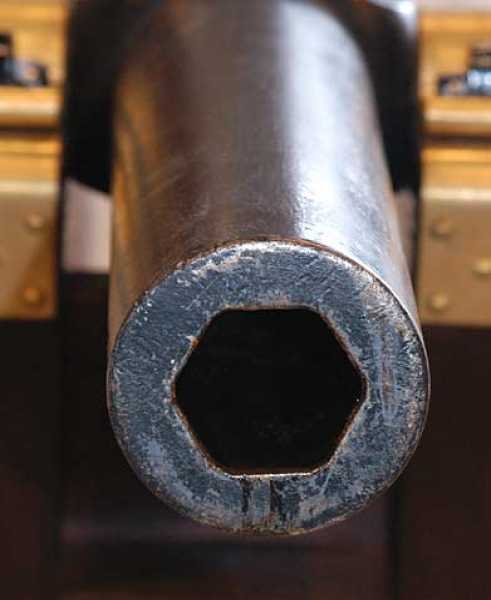

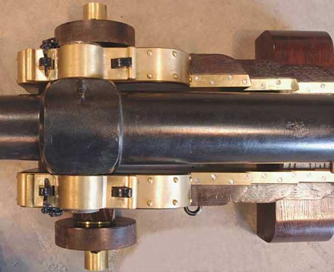

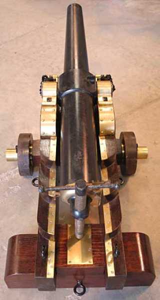

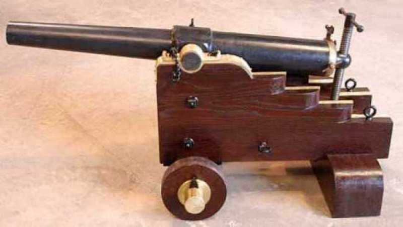

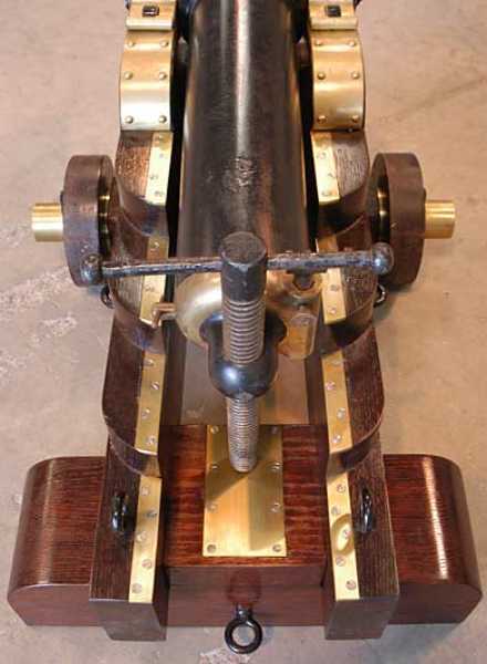

 Inspired by Shooter2s expedition I visited the Firepower exhibition at Woolwich, England, this week to look out one of my favourite guns, a one-pounder Whitworth.
Attached are six pictures of the gun and its fittings. The muzzle-loading, hexagonal bored barrel is cast-steel, 48 inches long overall and 9 inches across the trunnion ends. The tube has a brass breech ring for attaching the vernier sight and brass trunnion ends. The bore is 1.25 inches across the flats and 1.31 inches across the angles. There is a stub foresight at the muzzle but there are no marks at all on the steel barrel.
The brass trunnion ends have been “well polished” over the years making the marks indistinct, but a close examination shows that they read “Whitworth Ordnance Co.105 Patent 1862 Manchester”
The split-trail carriage is pale-blue painted wood, probably oak, the strap work and the base of the elevation screw have been nickel plated.
