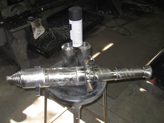

Here is my newest product . A GB gun with 3 chambers .
31" long without the tiller.
This one will leave soon .
Last photo before paint .
Feel free to comment . Armorer77

As you see it , the weight 46 lbs , the chambers weigh 11 lbs each . I can build another like this for $600 . Ed

That is cool! What kind of tollerences do you hold for chamber fitment?

The chambers are tight .  .007" dia.  Length + or - .003" The fit was resolved by a sliding breech block which has behind it a wedge with a mating taper cut into the breech . Providing as near as possible , 100 % support of the chamber .  Ed

armorer77,
Is that a free cylinder that rides in a pocket behind the removable chamber, pressing the chamber tight to the bore with a sliding wedge?

That is it . My design dilemma was how to allow the chamber move forward far enough to seal while allowing enough travel  to slide back far enough to come out while maintaining reciever integrety between the loading window and the wedge slot .  The answer was a spacer .  :o  Ed

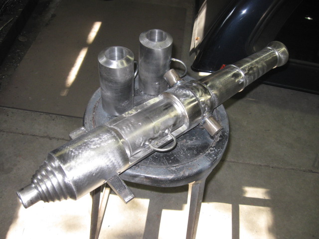

Ed,
What is this piece?

You are looking at the small end of the wedge .
