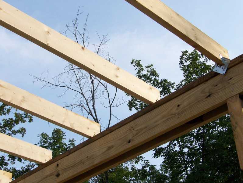

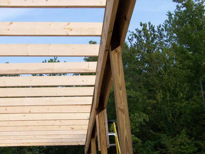

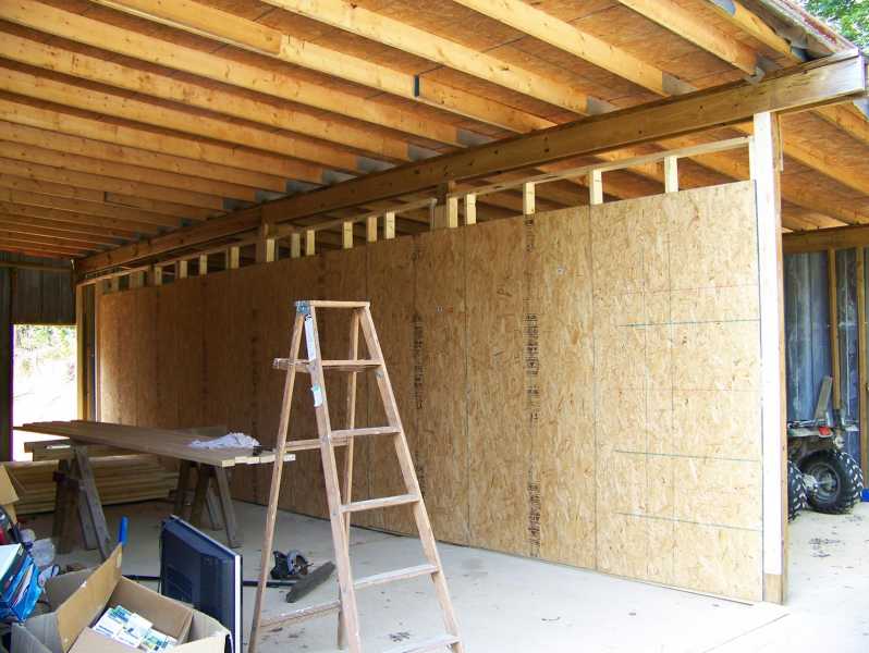

I'm not sure what you mean by shed/mono slope roof.
I'm gonna assume (yeah I know) that you mean a straight line roof rather than one with two sides like typical buildings have. If so the way I did it was by tying one end to my existing barn and then I had a mid support and far end support. Had I been making a stand alone shed rather than a side shed I'd have just added a third row of support posts.
In my case I used 4x4s at the ends and 4x6 in between. My shed is 30x36 so I put the mid supports 15' from barn wall and outter wall. I tied the posts together using 2x8s on both sides of posts and then used 2x6s as rafters. In my case I used 16' 2x6 and used metal plates to tie them together and rafter plates to tie them to the supports. I then used OSB to deck it and a metal roof over that.
