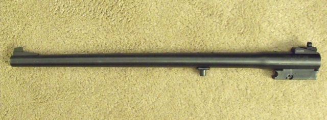

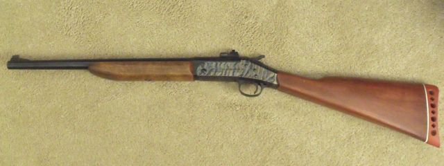

For those who just want more information and data (and who among us doesn't) - I have a 357 Mag 18.5" barrel on a Topper frame.
Like this, assembled gun: weighs 6.6 lbs.
Barrel by itself, like this:    weighs 3.2 lbs.
Someone who is more mathematically inclined could probably figure out a pretty good estimate of what a 16.5" barrel might weigh, but it ain't gonna be me.  :P
