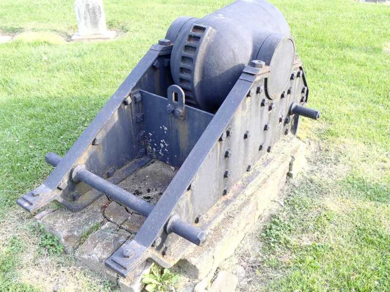

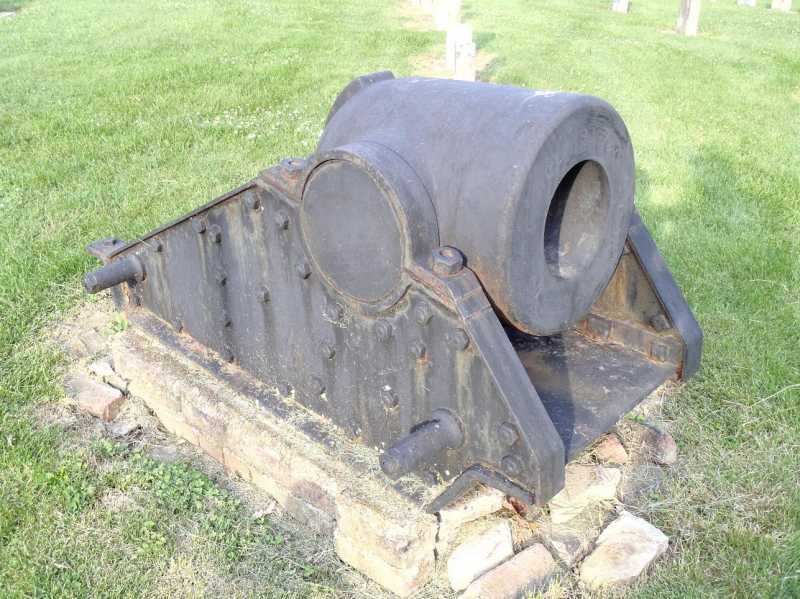

In the city of Danville IL there is a old cemetery and they have a soldiers memorial with a really tall statue and there are four equally spaced mortars that point outwards, the neat thing is all four are the same type (which I have no idea what they are) but they are all a little bit different, the square holes on the rounded part of the barrel which I assume was to lever the barrel up and down is most prominent difference, some have eight holes and others only have three, some have two vent holes and some have two with deep pocket like maybe priming powder was laid there? The one in the picture has like gear teeth cut into the trunnion while the other three don't. the one in the picture uses a tapered key to hold the cap-square closed and the other three use nuts and bolts. Of course I didn't have any thing to measure with so I don't have any critical dimensions to add, all I know is they are neat looking and just might have to be scaled down to say 1/4 scale.

     Well David, if they had looked like the one below, they would have been 8 or 10 inch 1840 Siege Mortars like several we found in downtown Providence, Rhode Island.  They were Confederate guns cast by the Tredegar.
But, of course they don't, so they aren't those we mentioned above.  They do look like this one we saw at Ft Independence in Boston Harbor, so they must be 1861 Siege mortars of the 8 or 10 inch persuasion.  Looks like 10" to us based on the relative size of the trunnion compared to the known length of the wrought iron bed's cheek bottom.
      David, you lucky guy, you!  If you will click on your second photo in the stack to bump it up in size, you will see clearly that you found the very first production 10" Seige Mortar of the Pattern 1861 series to be cast, S.N. 1.  It was cast in Boston, Mass. in 1862 by the Cyrus Alger Foundry( C. A. & Co.) and it weighed 1,960 Lbs.  Wow, a famous Ordnance Inspector too!  This piece was inspected and approved by none other than, T.J.R.,  Thomas Jackson Rodman.  Way to go!

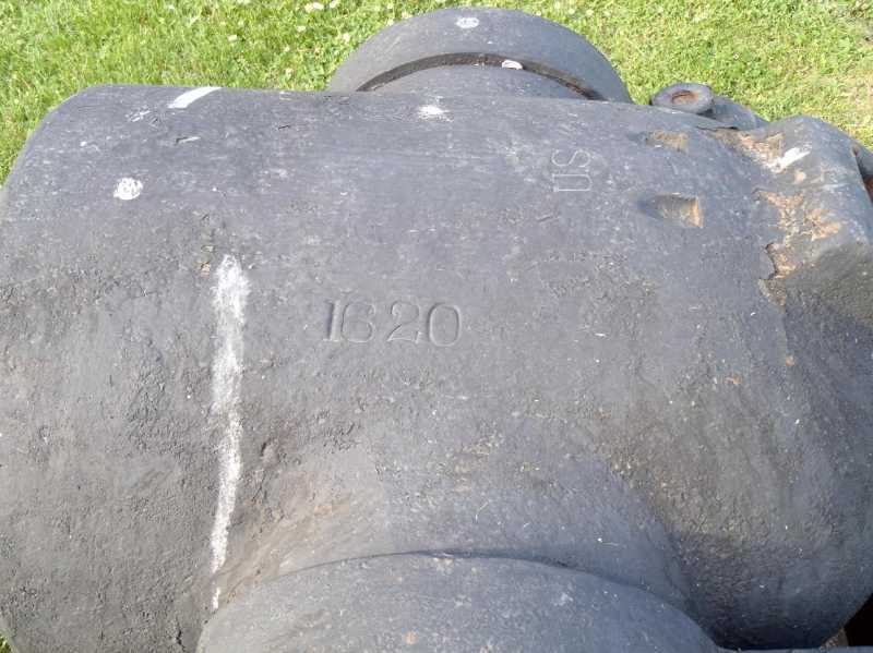

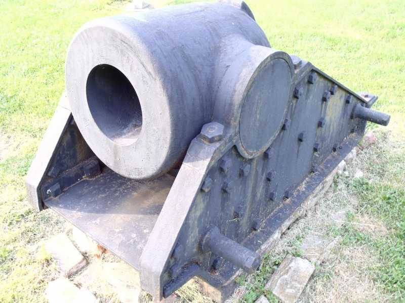

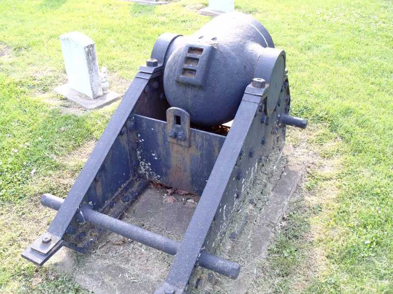

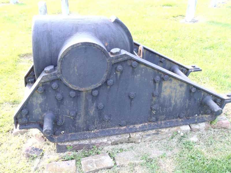

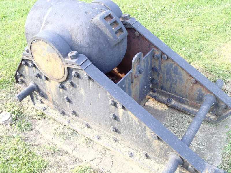

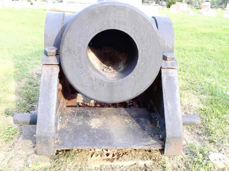

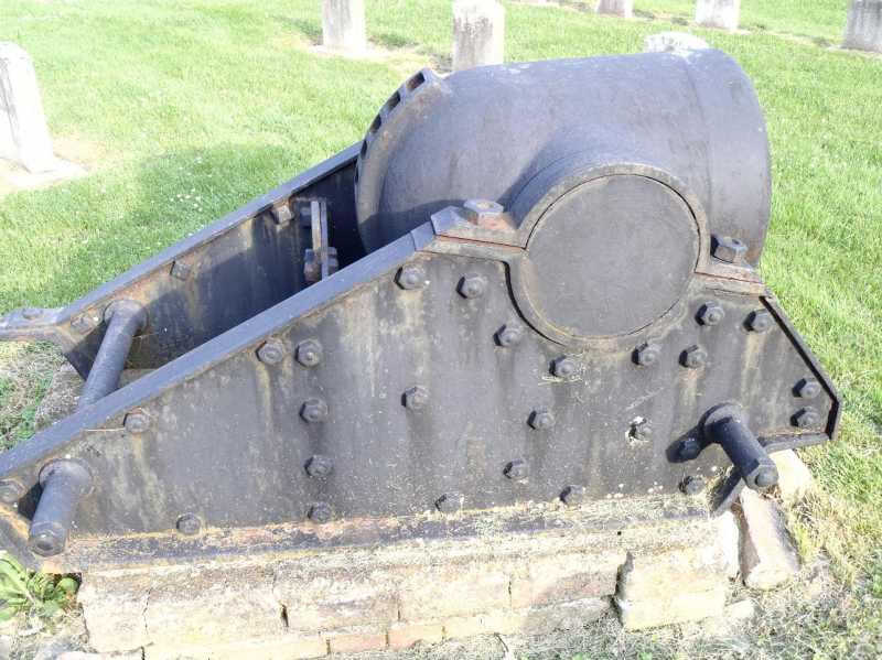

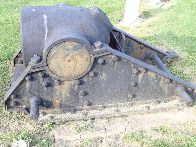

Here are half the pix I took today.  4 mortars, identified by location on the circle - SE, NE, NW, SW.
The South West Mortar:

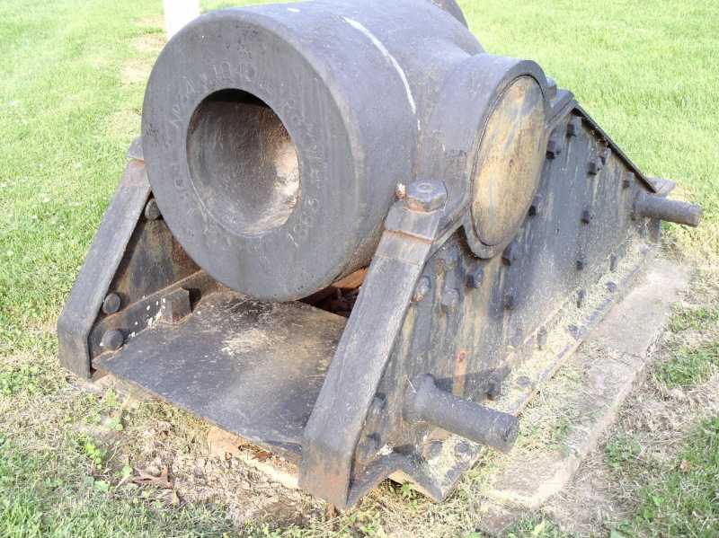

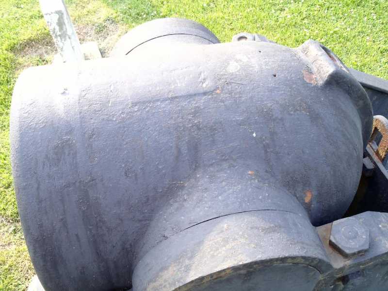

The South East Mortar
more to come.

Ok, thanks to rustychips and CW I think we now have good photo documentation on all four mortars.
The first eight (SW) pics Cat posted definitely show the Fort Pitt Foundry 10-inch siege mortar that weighs 1940 lbs. You can see the foundry number 1620 marked above the rimbase, and U.S. marked in front of the two vent indentations. This is one of the mortars that has three elevating sockets, the other being the Cyrus Alger & Co. registry no. 1 tube.
The next seven photos (SE) that Cat posted (I think) must show the Seyfert, McManus & Co. mortar; although I can hardly make out any of the markings on the muzzle face, through the process of elimination it seems to be from that foundry. I can't see all of them in the photo, but this tube may have eleven elevating sockets, because some of the other M1861, 10-inch tubes that came from this foundry did. This mortar also seems to have a muzzle ring, if you look closely at the pics you can make out a faint line around the front of the tube, and this mortar also has double vents, but with no indentations.
While I've admired the looks of M1861 10-inch (and 8-inch) mortars since first seeing them, I haven't really given them a lot of attention, but there appear to be some unique variations on different cast iron tubes. Other than the differing number of elevating sockets on these mortars, the most interesting feature to me are the "gear teeth" found on the trunnion face of the Cyrus Alger & Co. Army registry no.1, 1862 mortar. The only reason I can think of for the hole in the center of the trunnion face and the teeth, would be for the attachment of a lever to aid in the elevation of the tube. I wonder if this feature was dropped from the design early on, because it doesn't impress me as being necessary, and it's not found on the registry no. 17 tube.
Another surprising thing to me is the number of sockets on two of the tubes. I can understand that the reason for being able to depress the barrel to that extent would be to facilitate unloading the mortar; but what would be the purpose of being able to elevate the tube to the point where the bore axis was pointing almost straight up, could it have been to load or service the piece?
