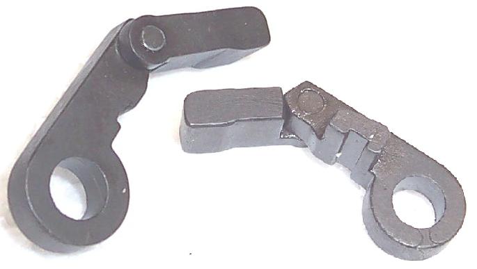

What was the deal with the Handi 35 Rem and 35 Whelen's FTF issues? What was the fix??
New improved transfer bar, I think.

I have a 35 Whelen that shot great the first two years I owned it.  Last year when I took it to the range I had 3 FTF in a row.  All three bullets fired on the 2nd or third hit.  So much for using that gun for bear season!! >:(  Beause of the great information passed around on this forum I contacted Remington to see what they would do.  They sent me a box and a shipping label.  The gun went to a repair shop in Illinois and they sent it to Illion because they couldn't fix it.  I was without the firearm for about 4 or 5 weeks but it was packaged very well and when I got it back it look just as good as when I sent it. :)  According to the paperwork they replaced the transfer bar and some springs etc.  I have not had the chance to take it to the range yet.
I had called the repair shop about the gun after they had it for about 3 weeks to check up on it.  The gentleman I talked to indicated that the "new" transfer bar is just like the old one.  Basically he said that someone tried to improve something that didn't need improving.  Makes no never mind to me as long as it goes bang when it is aimed at "dinner". ;)
So much for what he knows!  ::) If he was so knowledgeable, why didn't he fix it instead of sending it to Ilion?  ??? Glad ya got it fixed tho.  ;)
Has there been any of the new style transfer bar, aka lifter striker, pictures posted on here yet?
I don't know if this is one or not but it is considerably different from any of the ones in all the Handi receivers that I presently have.
The usual sloppy pin fit and peened look are absent and the fit is very close, with no wobble at all. The pin is flush on both sides as shown in the view of both sides.
Got this one from Numrich and it was listed as a "replacement". The "original" style was sold out at the time of purchase.
