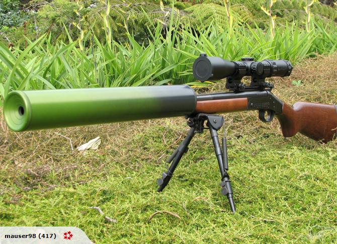

hi everyone.
i am from new zealand and have recently purchased a handi rifle in 500s&w. it has a huge suppressor and shoots subsonic 700gr bullets very quietly into an inch at 100 yds :D i have plans for the rifle which include getting another barrel in 308 or 7mm08 if i can find one (i already reload 7mm08) and cutting it down possibly along with taking a small amount off the stock to reach our legal limit of 30 inches. would make a great bush rifle for where i live.  just wondering is there any way i could possibly take a bit more weight off the beast? it is a budget project so i so i do not want to spend $$$ on barrel fluting etc. if i could find a synthetic stock for it would this make much of a difference? It's very hard to find barrel only over here and i may be forced to buy another whole gun which is around $500-$600
thanks.
adam.

« Reply #1 on: April 02, 2011, 12:09:20 PM »
here's a pic... hopefully! never done this before

« Reply #12 on: April 03, 2011, 05:28:39 AM »
Adam,
I really like your 500!  I am trying to imagine what your gun would look like if Stimpylu had a chance to paint it.  Stimpy is the Rembrandt of Handis. :)
