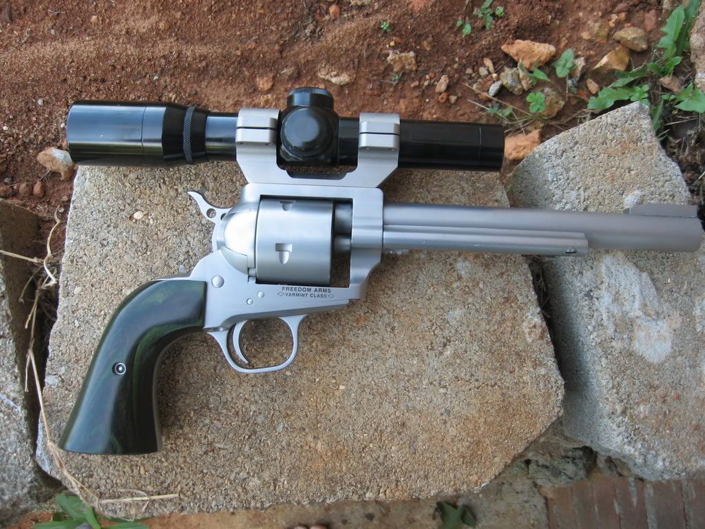

A 7.5" Mdl. 97 with T'SOB and 2X Leupold:

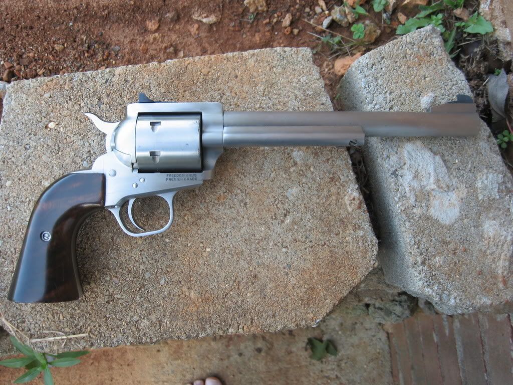

And a Mdl. 252 with a custom Gordon Logan base and a 4X Leupold:
Both are superbly accurate and have been used regularly for both target work and hunting. The Mdl. 252 / 83 is quite heavy and a 5 shot. I would probably recommend that a person get a 6 shot Mdl. 97 which is considerably lighter. Both are available with "Match" chambers which make the guns very slightly more accurate, but are a nuisance in the field, because they require thumb pressure (or a wooden dowel) to seat cartridges in the chambers. I would recommend "standard" chambers, personally... and they are still a bit tighter than, say, a Single Six. In the field, I can't tell any significant difference in accuracy of FA's standard chambers from the Match. I had my 252's Match chambers opened up to standard about 6 - 7 years ago. I've owned that gun since '96 and the Mdl.97 since 2002.
