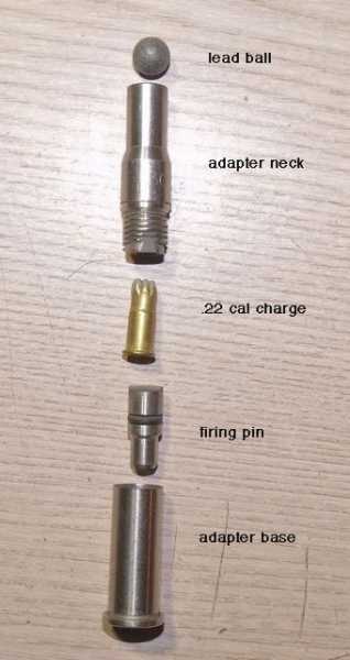

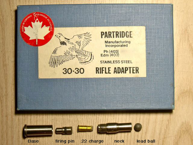

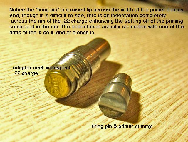

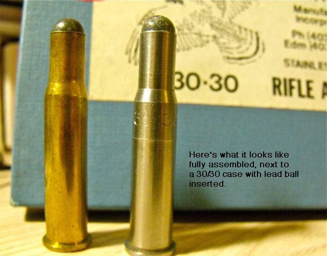

I have a machined stainless steel 30/30 case that I bought from a guy in Alberta Canada about 20 years ago. It unscrews about half-way up, and a .22 charge cartridge is inserted in. The two pieces are screwed back together, and a 30 cal ball pressed into the end. Load it into a 30/30 chamber, press the trigger, it goes "bang" and the lead ball departs the barrel.
He called them Partridge adapters and that's exactly what I used this for. It shot moa of partridge/grouse/rabbit at about 25-30 feet and put a number those tasty critters in the pot while deer hunting. It was not too difficult to chamber it quickly in the Handi when a grouse showed up, but a bit of a fumble to do it efficiently in a Model 94!
I have removed the phone numbers from the photos, 'cause about a year after I bought mine (I also had one for .308) he stopped making them, and the numbers are at least 20 yrs old anyway.
*psst. Tomf52 if I PM or email you would you consider providing more detail about the "miniscule" and "light" loads of Bullseye?
Here are some pics:
DECEASED 6/6/2013

Neat!

Quite incredible, Larry.  And for being in the 'right place' to meet that Canadian gentleman!
