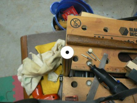

After reading about several folks shortening their barrels I decided to take it on
Started with a .223 Ultra barrel at 24".
Used a pipe cutter to mark my line at 20 inches.
Used a hacksaw to cut barrel off following the groove from pipe cutter
Then a file to remove cut lines and square (took my time with saw so it was easy)
Then 220 grit, stapled to scrap wood then 320 grit.
Next I used a end mill bit to counter sink the crown.  Wish I had gone a little deeper.
Then hand turned a silicone grinding bit (fits dremal tool) and then polished with dremal.
Then warmed the barrel and cold blued it.
see pics below
Hopefully the weather will be a little more cooperative next week so I can shoot it.

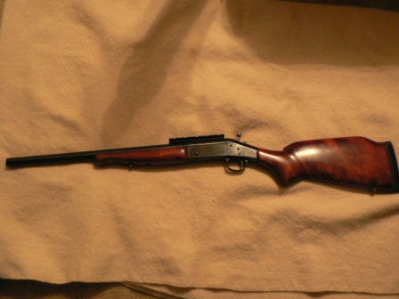

Finally got the pictures right.  Next mod will be to shorten the stock.
Wish it wasn't raining....Wife gets upset when I shoot off deck, not to mention
the Airdale..

Good post on how easy it really can be; you did fine on the muzzle too, it doesnt need to be deeper than that. Original Winchester '85s (the renowned 'High Wall') were finished flat at the muzzle; our 'target muzzle' notions are a pretty recent thing. As careful as most of us are about not banging the muzzles around, flat would be fine too.

Very nice job looks like you may of done some stock work on this one already? Kurt

Yes, I used a mixture of Cherry and Walnut alcohol based stains (that I have used on my muzzleloaders) and TruOil about 4 years ago.  Like the color just not happy with the TruOil.  Next time it will be a mix of Teak Oil and Formby's Tung Oil.  I have had excellent results with this mixture.  I hope to add a 357 mag barrel this year.
