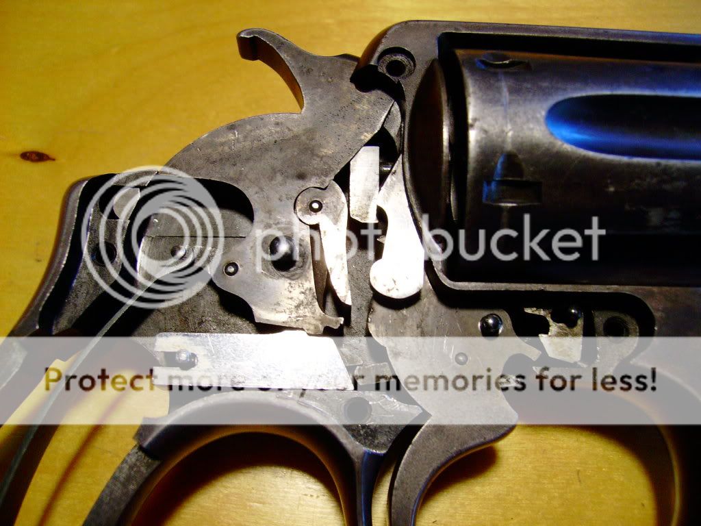

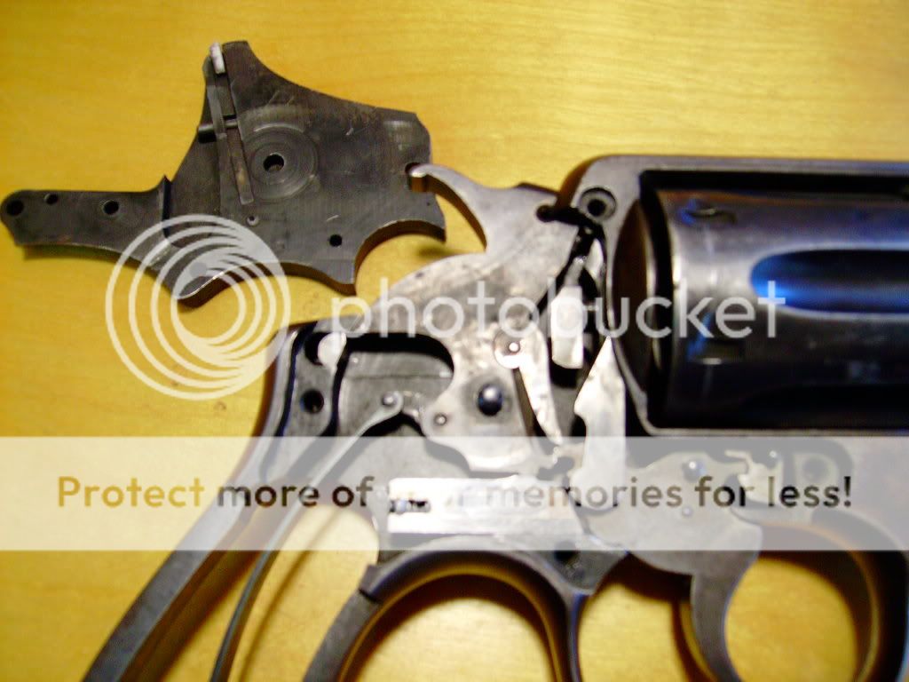

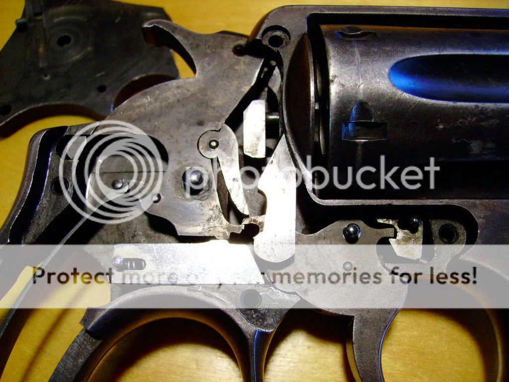

I have a S&W M&P 38spl (K frame) with the hammer block in the side plate that came in for repair missing a few parts, namely cylinder stop spring & plunger, rebound spring, and side plate screws.  Got replacements for these from GPC and installed them, but the trigger doesn’t return.  The trigger appears different from the others I’ve seen as it has only two holes near the pivot point, one for the pivot and the other for the hand lever, but not one for the hand lever spring.  It also does not have a vertical hole in the trigger for a hand lever spring either.  The trigger won’t return even if you relieve pressure on the rebound slide by retracting the hammer slightly.  Haven’t tried live fire yet.
I see no place for a trigger return spring, what am I missing?!?!?
Thanks for the help, you guys are the best!!

The link below should take you to a parts blow up. I can't see the trigger lever in it's spot at the rear of the trigger boss?(#70)? If it's gone that would likely be the problem? You might also check for a bent sideplate causing binding. The remnants of blue left in the cylinder flute really bring home the lovely finish these old S&W's had!

Does it lock when worked with the sideplate off? If so one should be able to watch the procedings so to speak and locate the problem.. Check the hand for clear passage in the slot and the cylinder for it's interface with the hand.  Be certain the hammer clears the locking bolt.. Might also check to be certain the trigger nose (front) is lifting (releasing) the cylinder stop. I would avoid snapping the gun with the sideplate off. It shouldn't create a problem but older S&W hammer studs(especially SS) can crystalize..   Alsp I did look at the parts blow up and the trigger is certainly oddly shaped.  If you look at the parts diagram for a M19 the triggger is very like yours..  Pay close attention to the action of the cylinder lock and it's interface with the trigger..  Don't forget to check the bolt clearance although that usually precludes movement of the entire action.  Look at teh rebound slide to see if it's been modified or is shorter..?
