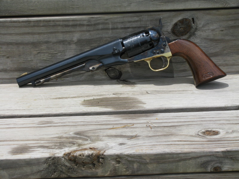

I started doing the cap and ball thing in 1972.  Ah, those were the days!  You could order just about any Colt or Remmie copy for around 40 bucks--and if I remember, 69 bucks for dragoons and Walkers.  I got several different models, delivered to me by mail to the post office, and shot them all.  I never did get a brass frame gun though, and never will.  Nearly all of my cap n ball copies are gone now, except for a 44 remmie copy, and that was my woods-walking handgun for years.  I still use it now and then.  I looked at your list.  Here's my 2 cents:  I've used wonder wads, and still do. But for starters you can use grease like Crisco, or if you prefer the store bought stuff, bore butter in a tube.  You don't really need a loading stand.  I've never had one, never used one.

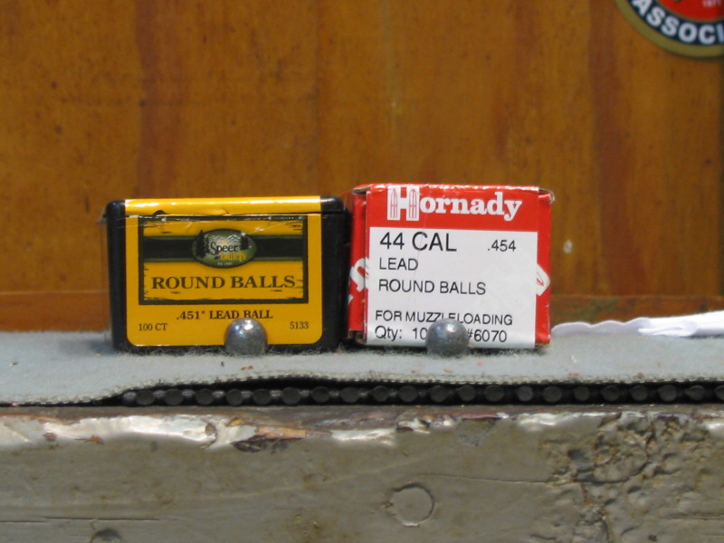

As far as ball sizes go, when I was really into it I used to get the Dixie Gun Works Catalog, more for information than buying products.  They were a good company, and I hope they still are. For a 36 revolver, I learned from them that 000 buck, bought in 5 lb bags, is a bargain and fits just right.  For 44 round balls, I settled on buying Hornaday 454's for everything.  That diameter is a good one to start with for copies of the old 44's, I found.  451's are a bit loose in some guns.

Wow, very nice pictures.  Thanks.
I'm debating on whether to get myself a Remington 1858 or a Colt 1860.  I'm at a loss as to which one I like more right now... I like the fact that the Remington has a top strap and how the sights work on it, but I love the casehardened finish on the 1860.  I saw that Cabelas was selling an 1858 with checkered grips and a casehardened frame, but I can't say that I like the grips on it... it would be perfect if they just gave you the standard, smooth finished ones instead.
