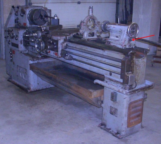

Rick,  Maybe there's a second lock?  My large lathe that I sold had two locks.  There is a lever lock on the side and a nut lock that is hidden under the turn crank.  I had the sliding problem until I found the second lock.

What I meant is besides the one underneath the lathe there may be another lock elsewhere.  My lathe has it on the end of the tailstock.  Red arrow.

I was going to make an adjustable prop that rested behind the tailstock and cradled the valley between the ways.  The prop would be made of a length of bar stock [1/2" x 2"' and have a row of holes in it.  It wasn't necessary when I found the second lock.  I needed it for the 2-5/8" spade bit.
