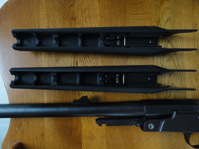

« Reply #7 on: December 18, 2010, 05:24:06 AM »
The answer is NO, the muzzleloader forend will not fit the shotgun barrel unless you alter the ml forend.  Graycg is right, the channel in the muzzleloader forend is too small for the shotgun barrel.
I bought a muzzleloader forend and carved it out so it fits the shotgun barrel.  It takes an hour of so of cutting and sanding.  I thought a drill or Dremel Moto-tool with a grinding stone would work, but that essentially melts the plastic and gums up the grinding stone.  I then tried a razor knife and found it works better.  You slice cut hunks of plastic off, and draw the razor perpendicular to the stock to 'shave' it down.  The lugs in the bottom of the forend are the main problem, although some plastic along the edges of the channel need to be removed.
I'll try to get a picture online.

From the top, 3 items:
(1) Shows the MODified muzzleloader forearm.  You can see where the lugs have been trimmed slightly to allow the barrel to fit down inside more.  The entire channel for the length of the forearm has also been widened slightly.
(2) The UNmodified muzzleloader forearm.
(3) The KP1 12gauge shotgun barrel, lined up approximately where the forearm will fit it.
