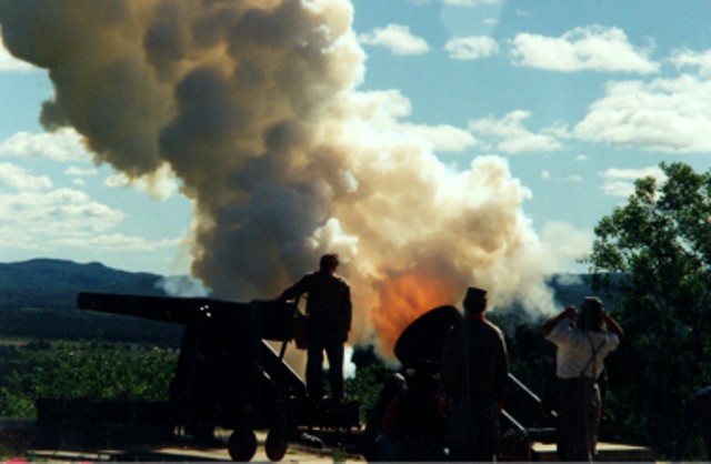

This is what it looks like when you fire a 200 lbs shell with 6 lbs of powder.  This was enough to move the 10 tons of barrel and mortar bed on the platform.

Sweet googly-moogly!  That's an awesome picture Artilleryman!
I imagine that was only shot on a rare occurance.  Where was this, and more importantly, do you have any video?

would that be at Range #10 at Ft. McCoy?

I don't remember the range designation, but the guns were mounted on Observation Point One.  The target area is one mile from the gun position.

« Reply #13 on: December 04, 2010, 11:26:47 AM »
Thanks, I remember seeing TOW's  and Dragon's fired from there from there in '81 - '82.  Could see hits out to 4000 meters or so, past that too much smoke.
Very spectacular.
The shells are loaded with flash powder?
Also the noise before and after the impact in the first clip, is that from the shell going through the air?
Offline Artilleryman
  • Posts: 1378
Re: The Dictator siege morter's barrel
« Reply #15 on: December 04, 2010, 02:39:35 PM »
As I remember it the shells were loaded with 7 lbs of BP.  Down range the incoming shell sounds like a jet plane approaching.  I haven't heard that type of audio after the shell exploded in other clips that I have listened to.  The whistling sound I believe is the sound made by the fuse hole as the shell rotates through the air.

Thanks for the videos.  I have seen them, but didn't make the connection between them and the picture.

God bless the Paulson Bros.; thanks for posting the pic Norm, that's a fine shot.
