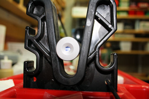

Here are a few pictures of my 22 K Hornet and some targets shot.
It is a stub done by Dinny's friend on an SB2 frame
It shoots great and the cases do last longer, but I like WW296 and CCI small pistol primers best for my light bullet loads and 20" heavy barrel.
Here are a few targets shot at 100+ yards
I am not sure about the nickel plating. I have heard them used on 30-30 AI and being OK. Personally I steer clear of them, just too many problems and a premium price.
I sure like showing my 22K Hornet off
Good Luck and Good Shooting

LaOtto222,
  That's how to do it! It looks as well as it shoots.

Nice shooting hornet you have there!!

Nice lookin and shootin Hornet LaOtto222!  One of these days yer gonna nail that dime, I just know it. ;D  I have some nickle plated 280 and 7mm-08 brass that hasn't given me any problems, yet, but have only reloaded it once.  Loaded up on some Win. ammo on closeout several years ago, $14.00 for the 7mm-08 Failsafe 140's and $12.00 for the 280 Ballistic Silvertip, I cleaned em out of both, that's how I got the nickle cases. 'Bout out of the 280, still have 9 boxes of the 7mm-08 and my BLR just loves em.  DP
