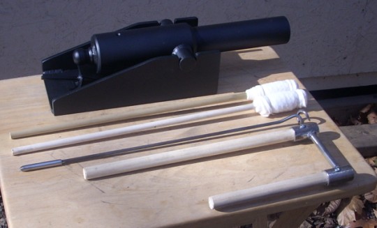

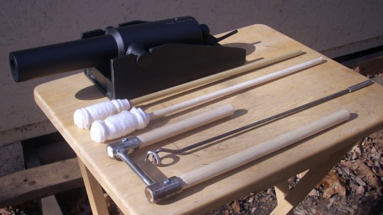

Here's the set-up I use.  The barrel is 12" long and can also be lifted off the base and held vertical for pouring in powder as an option.  I use a 3 OZ. cannon ball sinker [.966" diameter] for ammo. It uses a quoin for elevation and the entire package weighs less than 20 pounds. Happy Thanksgiving!

A little bit later on Dom's excellent wet and dry sponges; that's the way we make 'em!!

Here's my heavy little 1-inch Dahlgren built by SBR.  Great little shooter with cast iron carriage.  Has a brass slap hammer but a fuse will easily fit right down the musket nipple if I desire to fire with a regular ole fuse.
Offline Blaster
  • Posts: 637
Re: Shooting the 1 inch bore. Show us your gun and accessories
« Reply #18 on: December 02, 2010, 03:22:24 PM »
Looks like the picture was lost in transmission.  Oh, no big deal anyhow.  I'll try it again.
http://img.photobucket.com/albums/v310/bobjan/Korkcannon007-1.jpg

Pictures show up real nice  Bob all three times....I have another picture of it.

Thanks Doug.  Don't know what happened with my first posting of that pix.  I made the post on Nov 29th and the picture was included and showed up in the thread just as it was supposed to.  I thought I'd check out the thread to see if any comments on my Dahlgren on Dec 2nd and there was no picture included with my Nov 29th post.  Blasted thing kinda disappeared so I thought I'll fix it by quoting my earlier post and do the pix again.  Wouldn't you just know that after I made the second post, the first one came back with the picture.  Tried to delete the second one since didn't want to waste band width on a duplicate - found can't delete our own posts.  So.............. ???
