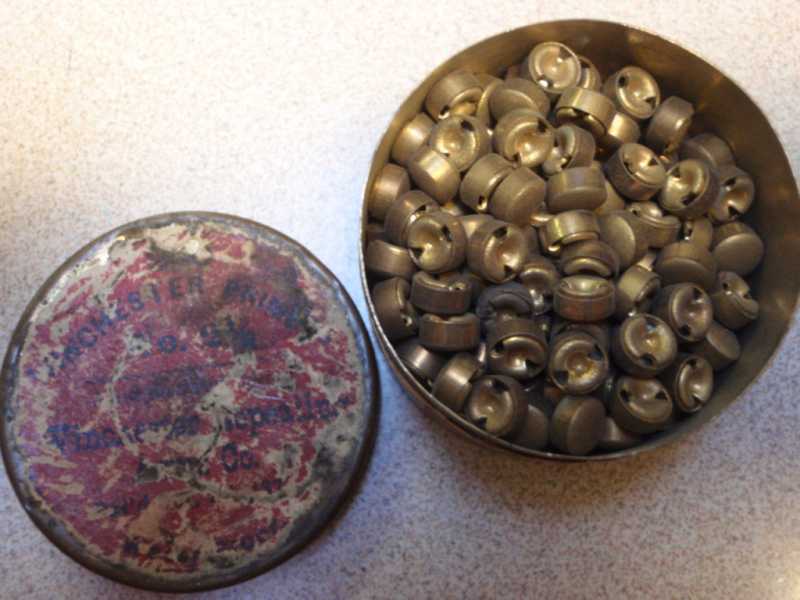

   Found an old brass tin of winchester two and a half primers , and dont know if they are for rifel or pistol.

A quick search of a few resource show that Remington and Peters used 2 ½ for Large Pistol primers .210”.  You have evidence of Winchester using the 2 ½ identifier.  It would not be the first time Winchester has changed its primer identifiers.  Somewhere down the path Winchester switched from numbers to letters.  Must be those marketing guys.

In my oldest Lyman manual (1967) it lists Winchester primers as follws:
Large Rifle 8 1/2
Small Rifle  6 1/2
Large Pistol 7
Small Pistol  1 1/2
The only reference to a 2 1/2 I can find is Remington and it is a Large Pistol primer.  These could possibly been
mis-labeled.  If they are brass colored I would think they are Remington primers.
Ken

Found these on a vintage firearms auction website that are dated 1878. No idea on what their use is (was).
Besides the No. 2 1/2 the other three tins, a little hard to see in this picture, have No. 1 1/2, No. 2 and No. 8 W
