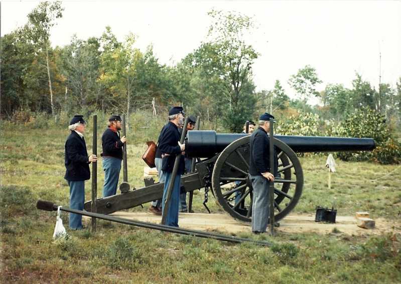

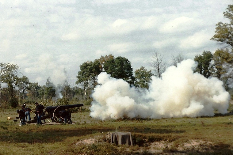

A couple of images that might be of some interest.
Re: 30 pdr Parrott
« Reply #1 on: November 29, 2010, 12:29:48 PM »
Is that a cast iron barrel?  Seems like the two forward men are taking some risk if it is.

« Reply #2 on: November 29, 2010, 02:50:35 PM »
It is an original barrel.  This gun belongs to the Paulson brothers.

« Reply #8 on: November 30, 2010, 07:02:00 AM »
Thanks for posting the pics, Norm; That's one long gun, and it belched out one long plume of smoke.
