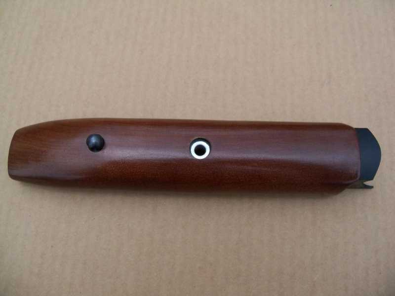

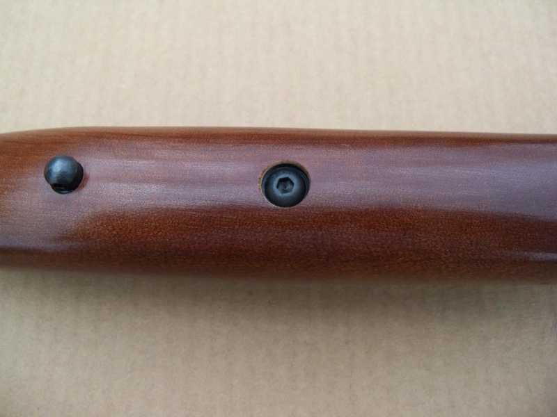

I had the problem fixed once and for all.  ;)

That forearm looks great Dinny... your guy does nice work. ;)
I emailed him about some work too.

I sometimes think I am solely supporting him, he has so much of my stuff. ;D
