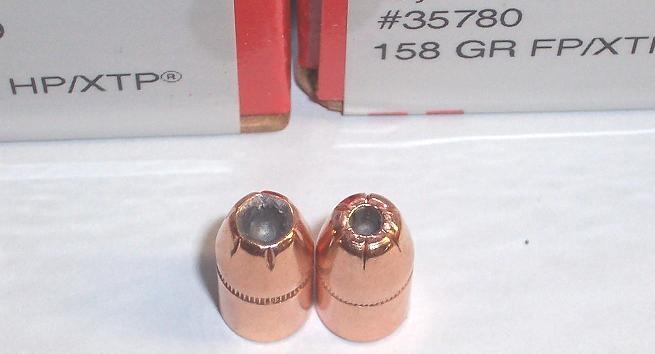

Design wise, they are very different. In shape and length. I have both in the 158 gr. and will see if I can get a picture of the two side by side so you can see the difference.

« Reply #3 on: September 18, 2010, 09:21:03 AM »
Here's what they really look like. The HP on the left, is a wee bit longer.

« Reply #4 on: September 18, 2010, 11:17:32 AM »
Thanks Bill for the pictures. I'm going to be using them in my new cut Maxi.  Thanks Tim  ;D

Hornady's chart on their website shows 1400 fps as the upper limit for the 158 XTP.
That is correct, for the 158 gr. HP-XPT #35710 but for the 158 gr. FP-XPT #35730, the Maximum Velocity listed by Hornady is 1800 fps.
