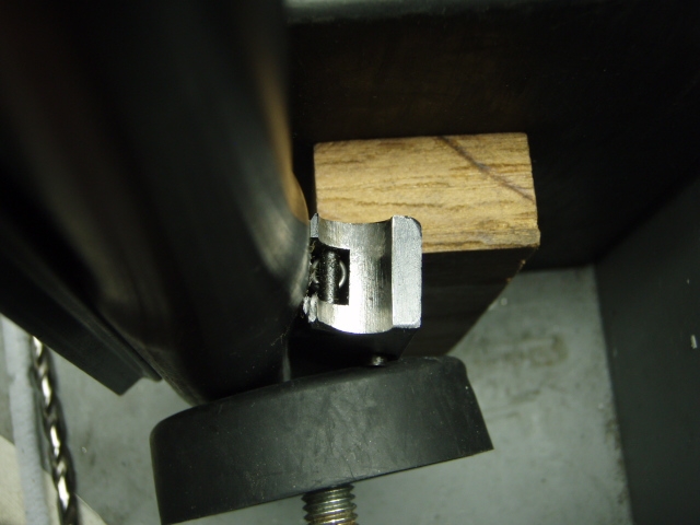

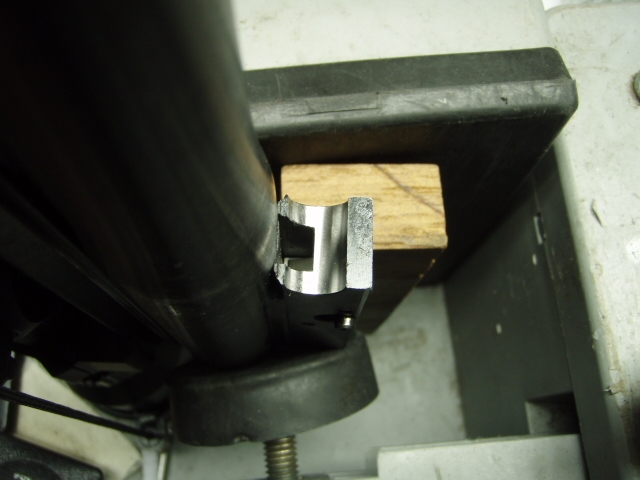

If you can get the hinge area filled with some weld, I have a 3/8 mill that I used to cut the new hinge for the shortened lug on the last project.  It is really easy to do and ends up with a better hinge cut than H&R makes.  Larry
Amen to that, night and day difference!  ::)
